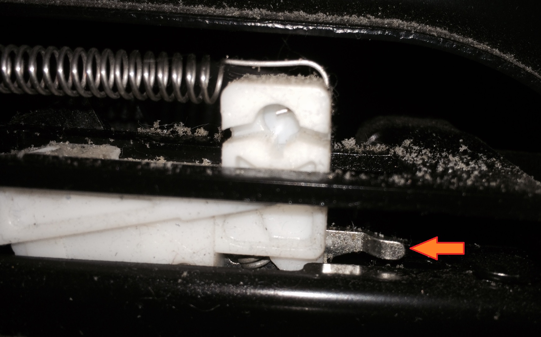

FIXED: Driver's seat didn't slide back further than memory position
My seat wouldn't slide back any further than my normal driving position. Nothing visible blocking the track. Raised the seat all the way up vertically. Used a hose removal tool (crooked pointy thing) and raised the metal part in the attached picture while holding the seat adjuster bar up and it was able to slide all the way back. Will see how long fix lasts.

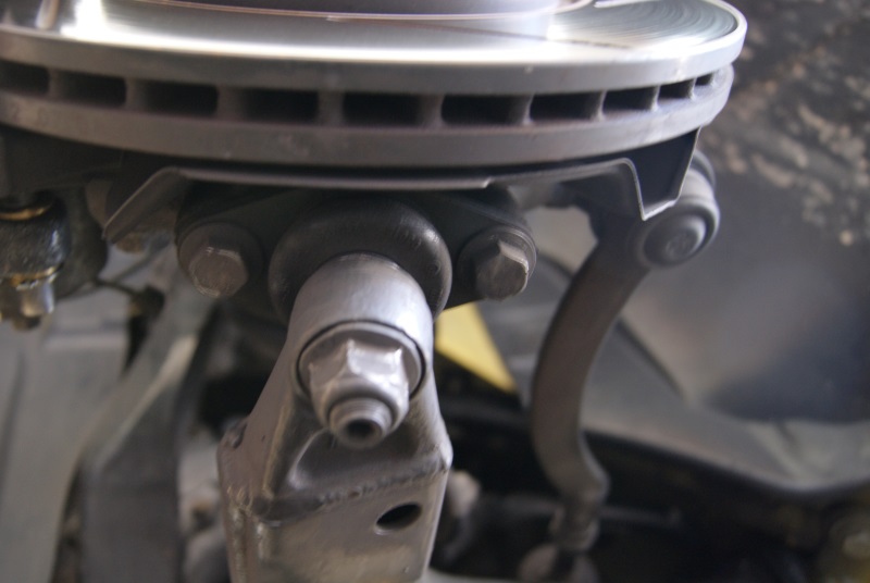

If I understand correctly, can't you remove the two torx screws/bolts holding the LCA to your hub? And then proceed with popping out the axle?
A lot of people avoid popping the ball joint and just unbolt the two bolts securing the hub to the LCA. That way, you can avoid any downtime. Just make sure you torque those two screws to the proper setting.
Two two bolts
Bolts removed and ball joint/LCA drop out of the way.

Yup, just spray some liquid wrench or wd40 on top of the hub and it should drop with a light tap.

Which would be fine.... except I can't replace the outer ball joints without separating them.
It required at least a quarter pint of penetrating oil and an air hammer w/ chisel when I did my struts.
Light tap!! LOLOLOL
^^^This is why I'm replacing my outer ball joints, BTW.

I guess I was lucky. I needed a pickle fork to separate the ball joint from LCA, but to get them off the hub was pretty easy if you use even pressure from the bottom and tap on top. I've heard they can be a PIA though..
