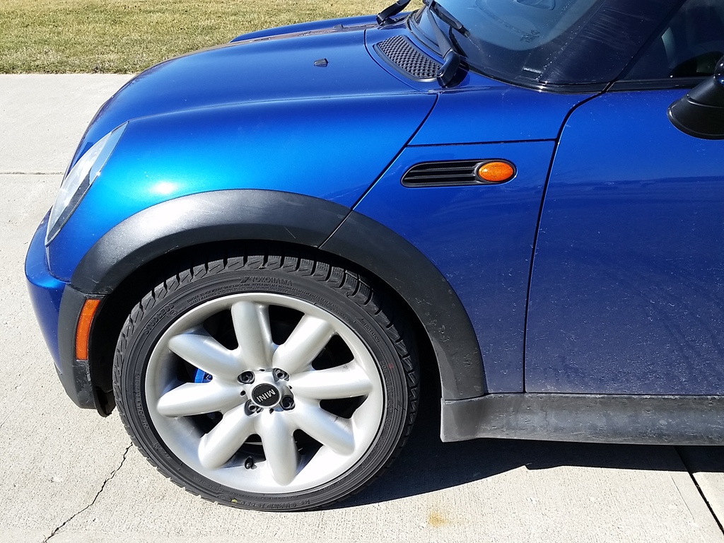

Changed from clear to amber lenses on the side scuttles. Just personal preference. I like having a little color. To me the clear lenses appeared maggot white. No likey.
He is DIRTY but going to stay that way since we have rain and snow in the forecast for this week.
BEFORE
AFTER

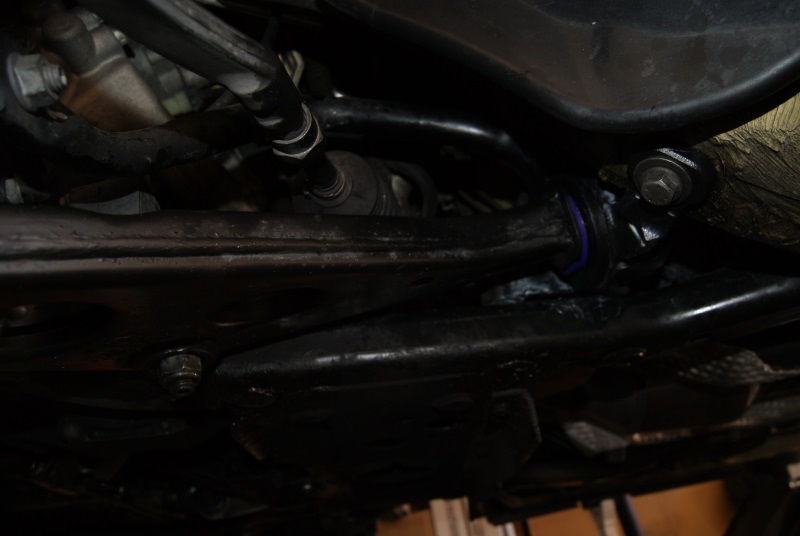

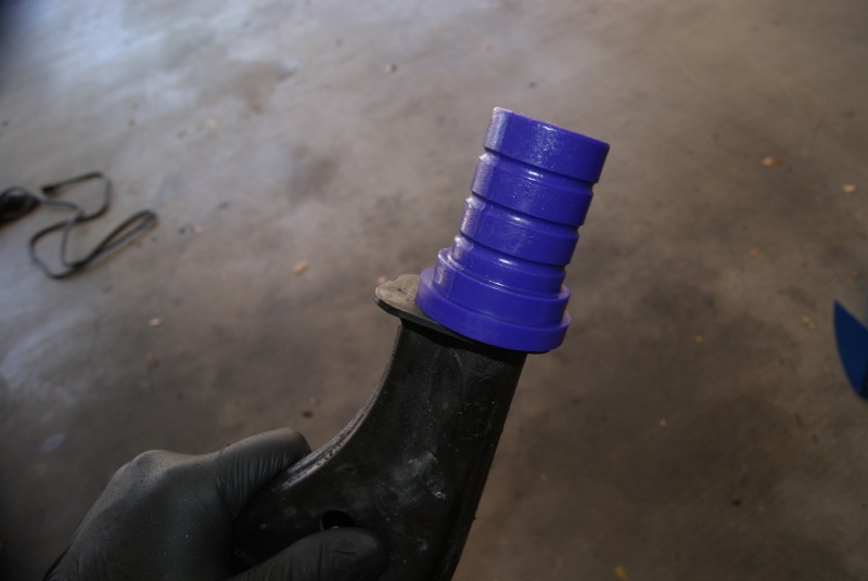

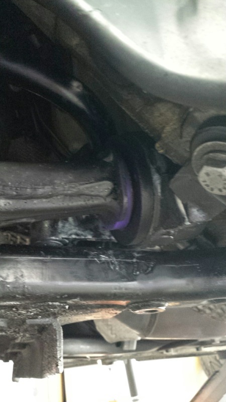

Tackled the lower control arm bushings on my MINI yesterday.
I really like the Powerflex bushings so far. Its like its 2005 all over again. More step by step pics in my thread.
Highlight reel:
Back to motoring…

Good work CooperSAZ... feels different... before and after? More in depth comments, observations?

Thank you!
Over time, I noticed the LCA bushings deteriorate. When I turned the car over, I heard an additional/slight vibration that sounded out of place. One that was like, "Great, what is coming next?" hehe While driving this sound was gone, I only heard it at idle and when I started to move from a stand still. Once I passed about 2k rpms, the vibration sound went away and it was back the MINI and Milltek.
Moving… Even pulling out of the garage and past the sidewalk, there is a decline/ramp that links the city street to the sidewalk. Slowly going down this ramp, you could feel the wheel turn and the LCA shift within the bushing collar. Not a great sound.
While moving, the car would slightly pull to the right (right bushing was toast) as if it needed an alignment. Even while driving on a city street or on the highway, the car felt twitchy. There are times it would want to (ever so slightly) pull to the left or pull to the right. So you had to keep one hand on the wheel for fear or “changing lanes”. So slightly annoying. What the MINI felt like and how it drove was a mere memory.
Even while getting under the MINI while he was jacked up, you could move the wheels a few degrees in each direction. Hardly ideal.
Post install, the first thing I noticed was coming off the driveway, past the sidewalk to the street. Going down the ramp, there was no sound, there was no knock. Just silence. I went for a quick stroll and the MINI felt very solid.
Going for a longer drive, the steering wheel was dead straight and steady. There was no twitchy feeling and the MINI did not want to pull in one direction or the other. I got up to 45mph on a straight stretch and let the wheel go. The Mini just went straight and did not “change lanes”. While driving, I noticed that the handling of the Mini was back and the slightest adjustment in the steering wheel, the Mini reacted. Very very cool feeling. So I made a left hand turn through an intersection without having to stop (at pace) and the MINI felt great! No secondary movements, no counter movements, it just went where you steered it.
I cant wait to throw on some Koni Yellows and TSW springs with a larger swaybar. This could get fun.
