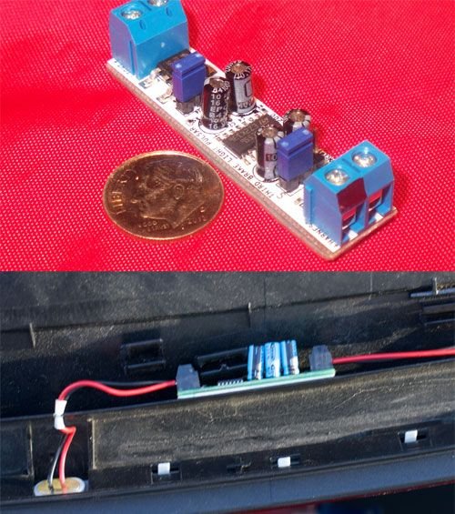

I couldn't find any Clubman specific photos of the pulsar brake light install so here you go. This was a very EZ mod for my '09 Clubman, plenty of room to squeeze the pulsar into the small space.
Brought the unit from Outmotoring, the one with SmartPulse but I believe it's the same unit the other retailers carry. Tools required: Torx t-25, scissors and small jewelers screw driver. A pair of wire strippers would also come in handy.

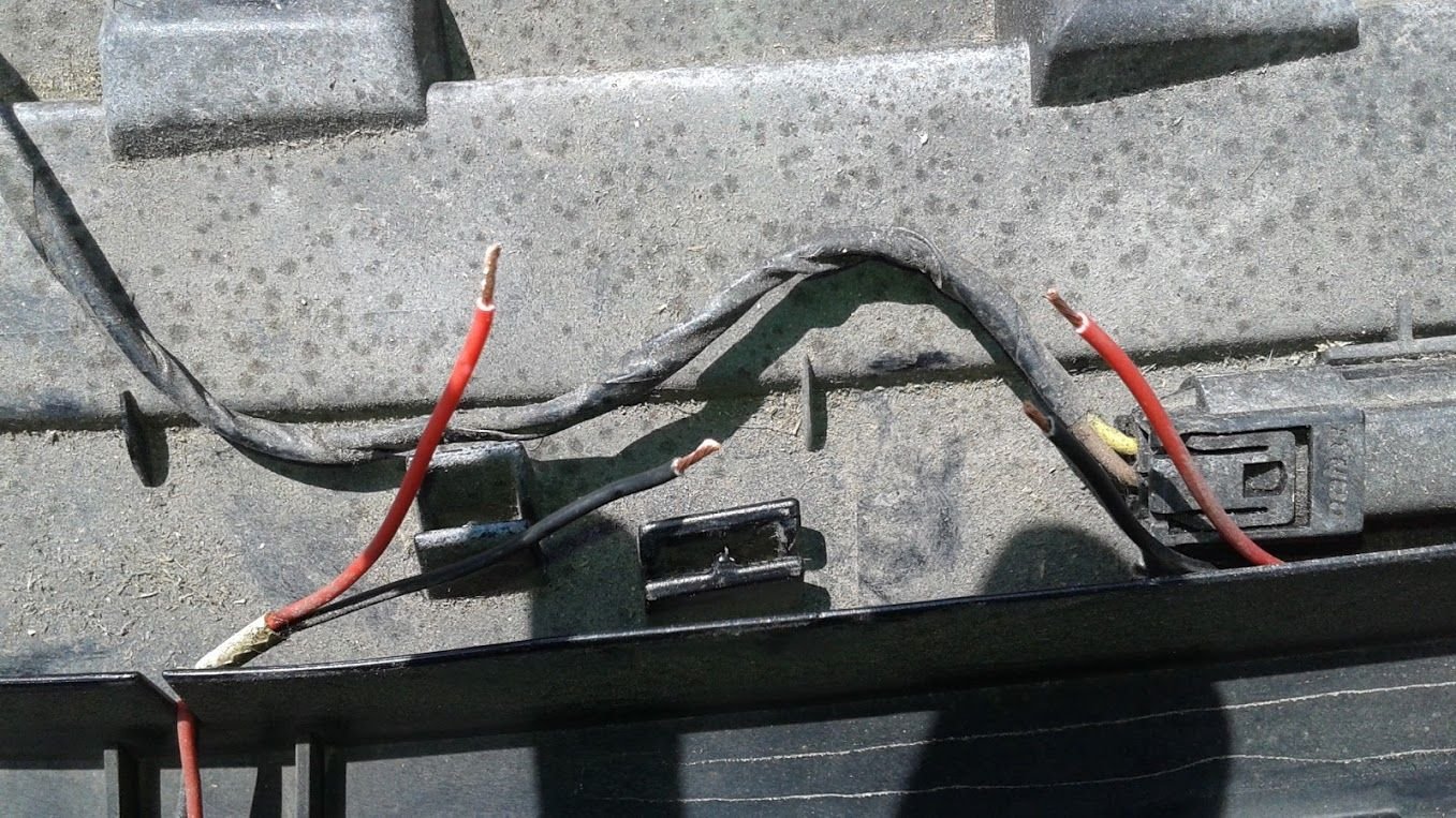

The only mod I made was to carefully pry out the little tabs [see photo] because I wasn't able to get a good grip on the bare wire in the stock position. YMMV.
[Top photo] This is what the stock unit looks like before prying the tabs. And this is with the tabs out...
Remove all 8 torx screws from underneath the light assembly and gently pull and it basically falls out and hangs down.
On my Clubman the wires were red for positive and black for negative. You don't have to remove anything else, simply figure out where you want to position the pulsar and measure where to make the single cut of the two wires. Then I used wire stripper to peel back the insulation [practiced 1st on the supplied wire in the kit].
* I first positioned the pulsar unit BEFORE I cut and put the light assembly back into position just to make sure it would fit.
Then I screwed down wires with the small screw driver, positioned the pulsar and placed the light assembly back [make sure the left and right end pieces line up correctly with the exterior trim before you put the torx screws back in]. That's it!
Tools.
