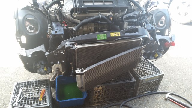

Put the car into front-end service mode, then swapped out the original OEM radiator fan (which had a failed resistor and thus, no stage 1 low-speed fan) with an aftermarket TYC unit. While I was in there, I pulled the crankshaft position sensor and changed the o-ring, which had been seeping for some time.
As part of my next oil service (in 4000 miles), will be a change of the valve cover gasket, oil pan gasket, camshaft position sensor o-ring and timing chain tensioner.
The ever popular front end service mode.
