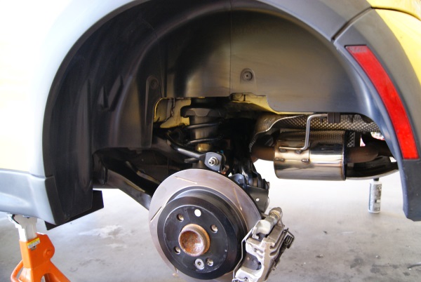

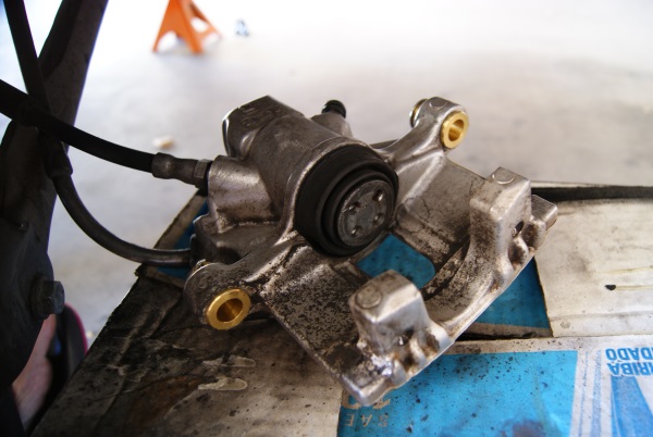

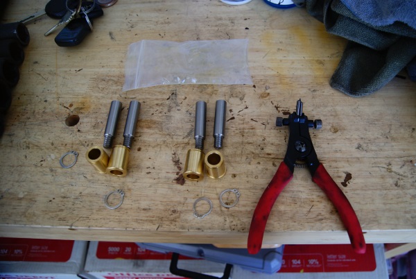

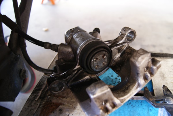

I am sorry to see other owners having a few recent issues. Hang in there!
Spent some time on the Mini today with swapping out the rubber caliper bushings. As the MINI ages, the brake pedal feel was becoming spongy. For whatever reason, that drives me nuts. So I recently bled the brakes and that improved things. I then took the next step since each set of pads/rotors are new to swap out the rubber bushings for metal bushings. My hope was to increase the pedal feel and I can say that I accomplished that…
There are more pics in the build thread but I will leave a few here.
The Kit:

Cleaned up

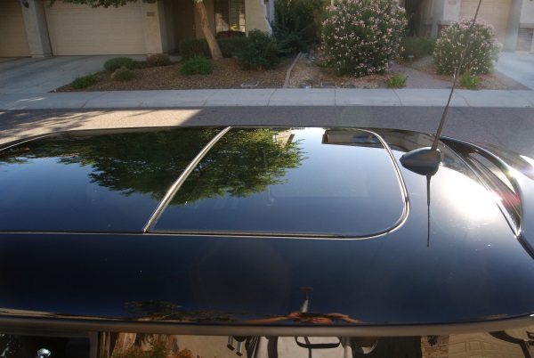

Bought a new Porter Cable 7424XP polisher and went to town cutting, polishing and waxing the roof of my MINI. Great results!

CooperSAZ, you might want to go to braided stainless brake lines to help stop the spongy pedal also. As the rubber lines get older they tend to bulge a little also when pressure is added.
Roof and calipers look really good.

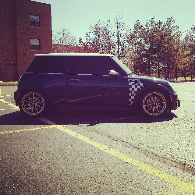

I took my MINI for its first solely for fun drive.

Oh I like those wheels, nice choice.
