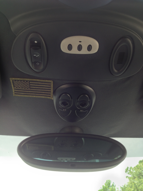

Installed my homelink today.
Attached Thumbnails What did you do to your mini today?-image-2416983500.jpg

Was it an easy install I'm about To do mine
BTW I am so jealous of your black roof "liner" my 2004 brg with anthracite interior an black panther leather still came whit that beige liner and clock 😞

It was fairly easy. Since I didn't have the clock, had to find another power source. First tried the vanity lamps in the visor, perfect until I shorted them out and could not figure out the fuse. So trashed that idea. Then I decided to go with the constant power to the sunroof. Worked great. As far as cutting into your console....cut small, miss small. Take your time and cut a little, test fit...cut a little, test fit. Oh, and the following link says to use 16 gauge wire.....way to big. I used 18 and was still too big to fit into harness on the transmitter, but I got it to work.
http://r53minicooper.wordpress.com/2...-less-than-20/
And I think I'm gonna pass on the trade offer.
