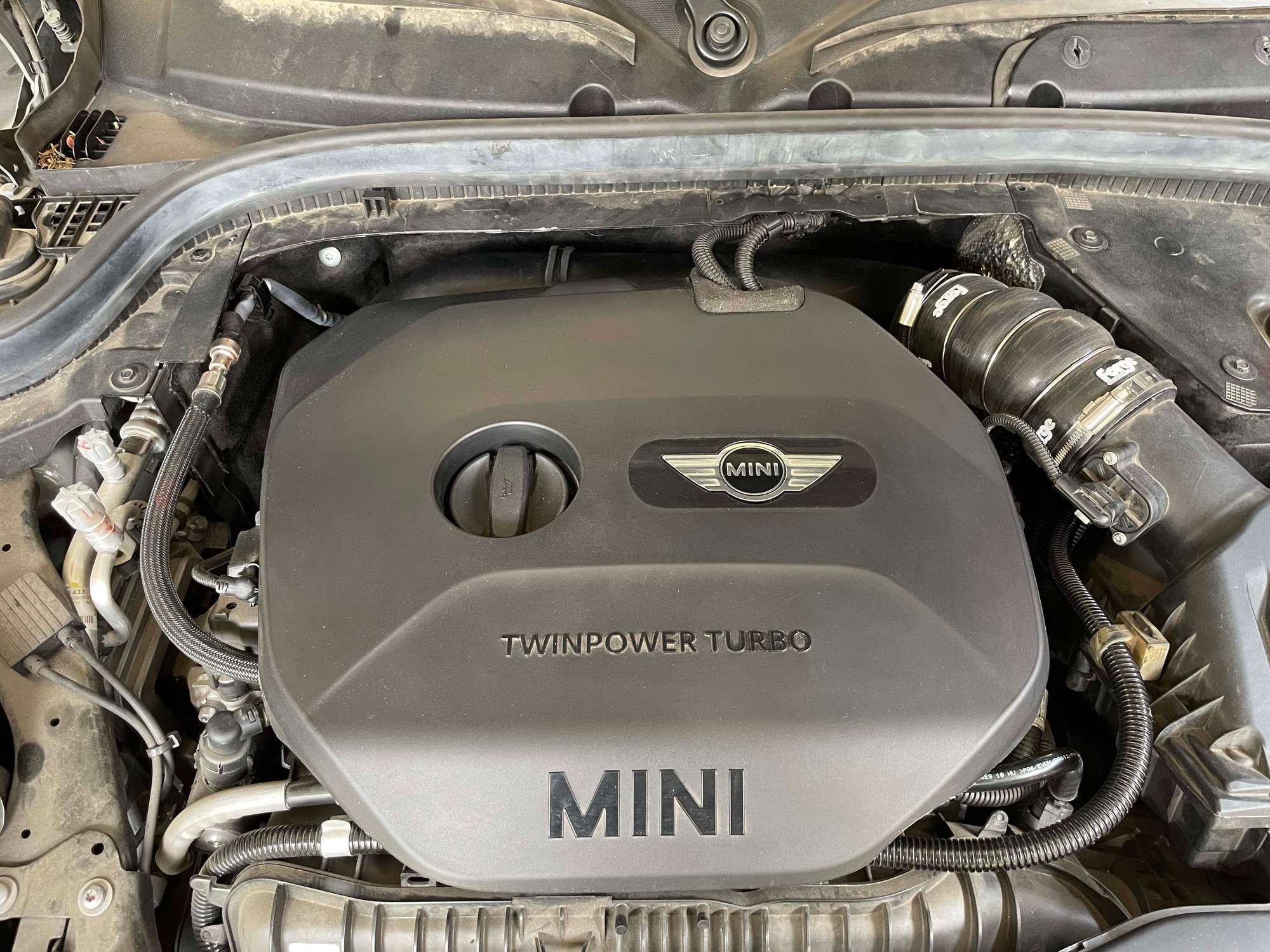

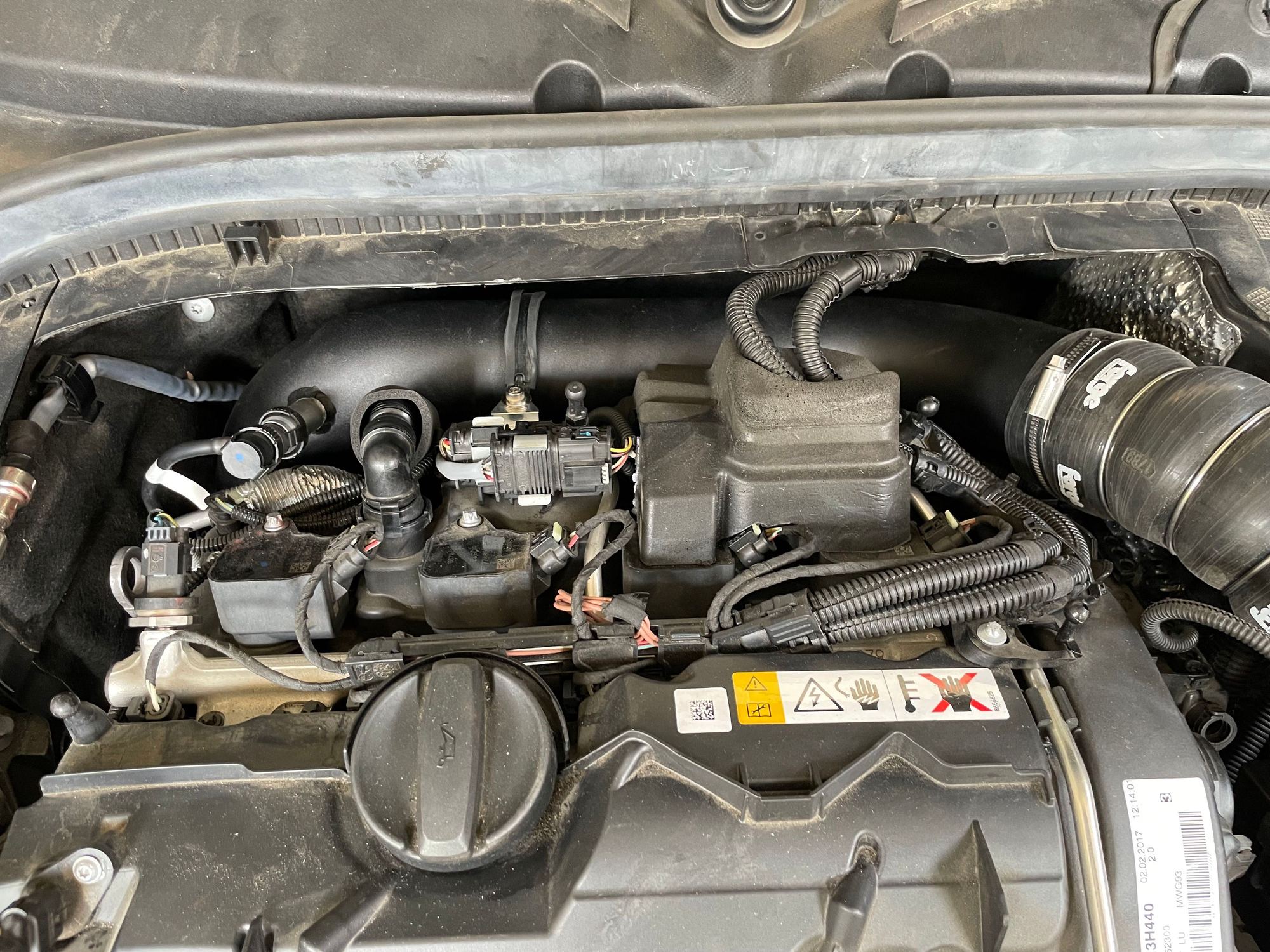

I decided to install my Forge Hard Intake Pipe today.
First a back story:
I always had an issue with high rpm upshifts, whereas it felt like too much boost was being dumped. You know
that burble between shifts so you dont jerk into the next gear (Auto trans). Mine would fall on its face hitting 2nd gear like the Turbo had
to spool up to regain boost.
Dealer would say thats the way it is.
(BURBLE= The wastegate dumping off boost)
Fast forward to today:
I remove the air filter with the MAF intake pipe, then remove the intake center bolt to the engine, and WTF the intake pipe to
the turbo inlet falls over!!! I looked down and the spring clip was never engaged!! The intake pipe was never seated!!!
Was this a Monday car, Dutch drank too much on the weekend?
So, I go on and install the Forge pipe, along with a new turbo inlet seal. (2 hours start to finish)
ROAD TEST!!!
My upshifts are hitting as hard as I believed it should have been form the beginning, and a shorter (yet louder) burble between shifts, and my idle
has smoothed in Sport.
IMPRESSIONS?
I now cant really answer whether this pipe was worth $300, as I have nothing to compare with due to the OEM pipe never fitted
properly!!
FIY car was built 2/2017 in the Netherlands assembly plant.

And... I lost the grey lock to the Blowby heater connector!!! I might remove the under tray, probably will find all the grey locks Ive dropped!!
Did not remove any bits above, but had to remove the OEM snorkel to get the intake body out. Also the front battery wall kept it from coming out. Removed that too.
