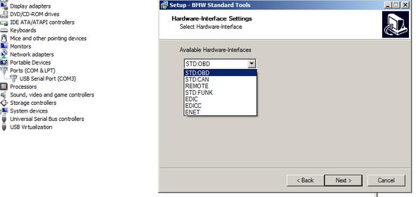

Having issues installing NCSExpert both on my Win7 64 laptop (i know there's issues there) as well as in the Microsoft virtual XP with the D-CAN USB attached. I followed the driver install portion of the guide without issue, and now I have COM3 which is the cable. However when I go to install NCSExpert I have no COM3 option in the hardware interface section, as per the attached pic. Any ideas? I've tried re-installing the cable without luck =/
