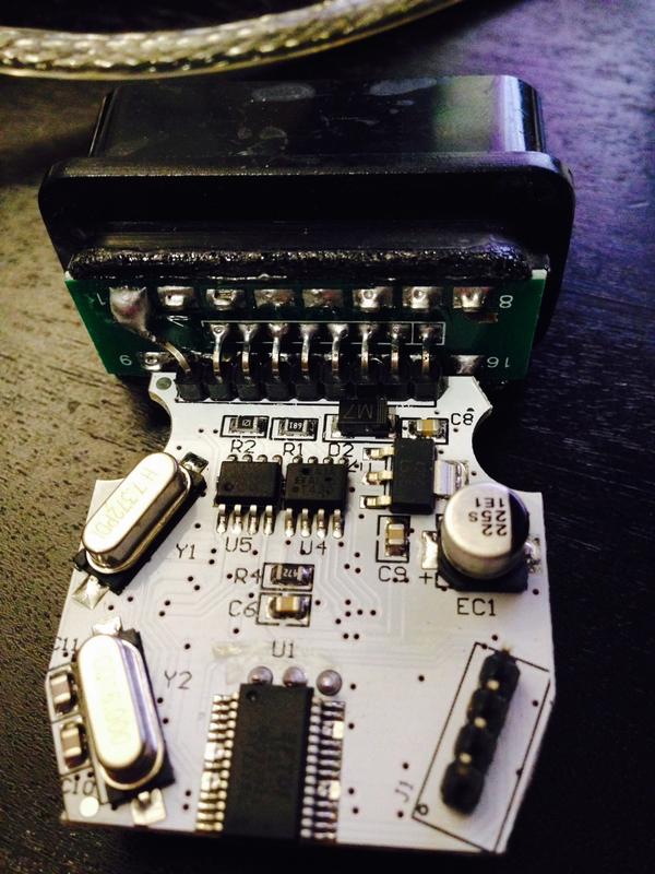

Has anyone here added the 25W Xenon Retrofit headlights replacing halogens to their car, if so have you coded using NCS Expert to get them added? I read this post: https://www.northamericanmotoring.co...rofit-kit.html and I'm just trying to get a step by step for really easy DIY for the R60.
Old Jan 15, 2015 | 01:45 AM
  #1073
shdwkeeper's Avatar
shdwkeeper
Joined: Jan 2015
Posts: 26
Does this look like the working cable everyone is talking about? I don't see pin 7&8 soldered together unless I'm looking in wrong spot.
Attached Thumbnails Countryman-Specific Coding - R60 Guide-fullsizerender.jpg   Countryman-Specific Coding - R60 Guide-fullsizerender-1-.jpg
