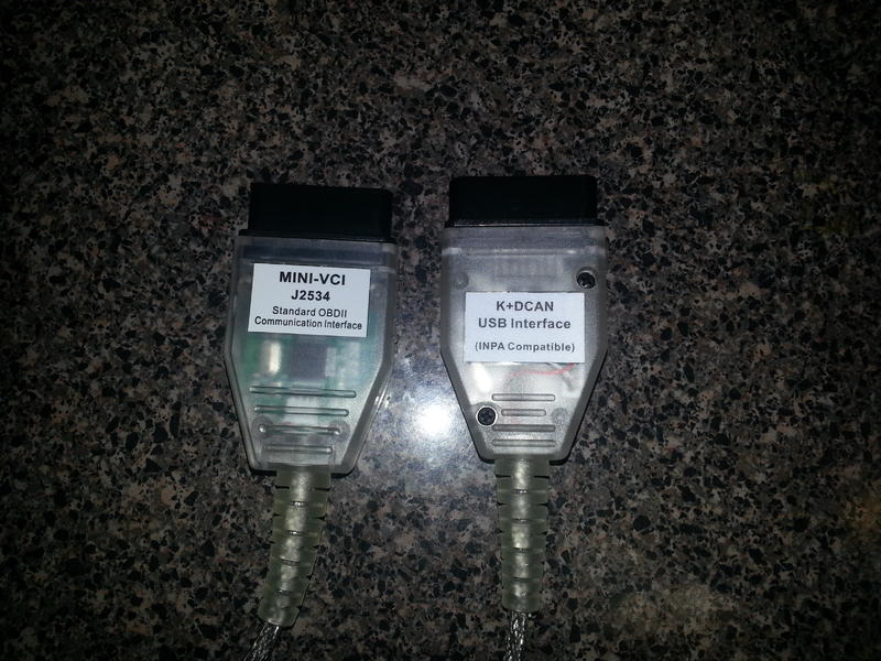

The China eBay worked with me and said they would send me a new cable. Today I got the cable and tried again. The cable on the left (green board) was the original and INPA would not connect at all. The new cable on the right (white board) does connect to my laptop in INPA showing Battery and Ignition and "ON" with FOB in and one push car on.
NCSEXPERT still will not connect. Referencing https://www.northamericanmotoring.co...7-post954.html
I tried both updating the COAPI.INI and using the old one which (not overwriting it)
The old one gives VIN error and the new gives CHASSIS Faulty error.
Is the cable still the problem or my software? Should I ask the China eBay guy for a refund or is this user error?

The China eBay worked with me and said they would send me a new cable. Today I got the cable and tried again. The cable on the left (green board) was the original and INPA would not connect at all. The new cable on the right (white board) does connect to my laptop in INPA showing Battery and Ignition and "ON" with FOB in and one push car on. NCSEXPERT still will not connect. Referencing https://www.northamericanmotoring.co...7-post954.html I tried both updating the COAPI.INI and using the old one which (not overwriting it) The old one gives VIN error and the new goves CHASSIS Faulty error. Is the cable still the problem or my software? Should I ask the China eBay guy for a refund or is this user error?
Software now. Try doing a clean uninstall, restart and then do a clean install with just the updated datens, not the old ones.

Its a pure problem with cable. White circuitboards works with mini up to 2008. Green works with my CM 2013. The previous one was correct but faulty. The New one will not work. Your SW is probably OK. My simple tip os to choose cable above $80. Maybe it's not a rule, but generally those one works.

Thanks I will ask for eBay refund then. Don't think I'm going any further. Throwing away $80 for cable after cable for trial and error is not good. I took this chance since I wasn't worried about less than $20.
