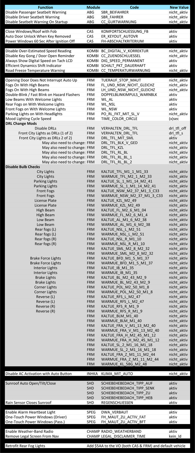

I assembled all of the codes I could find into a single organized, pretty chart. I thought this might be a little more helpful than the many databases that are out there, most of which are missing a few things. If anyone has anything to add, please let me know, I'd be happy to add them both for myself and others. I'm very interested in finding out which bulb corresponds to which bulb code.
Image updated 9/9/12
Thanks for doing your own thing ... however the excel file on post#1 has all the codes into one single organized spreadsheet already.

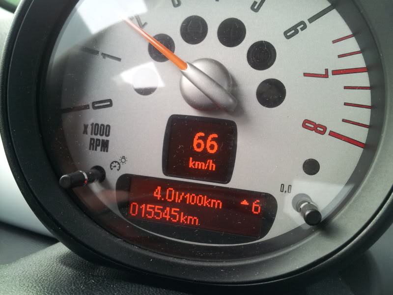

Hello GTECKO,
Efficient Dynamics Shifting Indicator has been working well. It is active all the time. PLease see below screen shot for reference. IT will suggest shifting up always, but once in a while it will suggest downshift (ie. going up an incline)
True, there were a few things missing the last time I looked at it. I just made it for myself, found it a little easier to follow, and am posting it in case others find it easier too.
Originally Posted by TRIPLE_O
calforhelp, LH_UND_NSW_NICHT_GLEICHZ should be set to nicht_aktiv
Thanks! I've added more codes to my list and determined what more of the bulb codes correspond to so I'll update the picture in a little while.
a few things missing ? When Im checking your screenshot, I do not see anything different, apart from the error on the fog light on code. Anyway, thanks for the iniative, its good you did it for your self, however there is more than 700 ppl following the spreadsheet, I cant have someone throwing wrong codes on this thread. Hope you understand that. If you do have anything new, let me know and I ll add it.
@wai_jai268 , TRIPLE_O askd some good question that will potentially help us find a solution for you.
Iam trying to code the Efficient Dynamics Shifting Indicator tomorrow as Iam off
was wondering why it shows 6 gear and you doing 66 km/h humm ?

Originally Posted by GTECKO
A few things missing ? When Im checking your screenshot, I do not see anything different, apart from the error on the fog light on code. Anyway, thanks for the iniative, its good you did it for your self, however there is more than 700 ppl following the spreadsheet, I cant have someone throwing wrong codes on this thread. Hope you understand that. If you do have anything new, let me know and I ll add it.
Check again, you'll see quite a few things missing. Welcome Light mods, far more bulb checks that are labeled, mood lighting cycle speed, and a few other little things. Also not everything on your spreadsheet is complete, some are missing wether to set the line to aktiv or nicht_aktiv.
Yes, there was one mistake but that's less errors than the other database. With 700+ people having full R/W access to something, it's bound to get screwed up, they can't however screwup a JPEG. Any problems aren't your fault, it's just what comes with that many people having free access to something. I appreciate the work you put in, it's what enabled me to get my system up and running.
