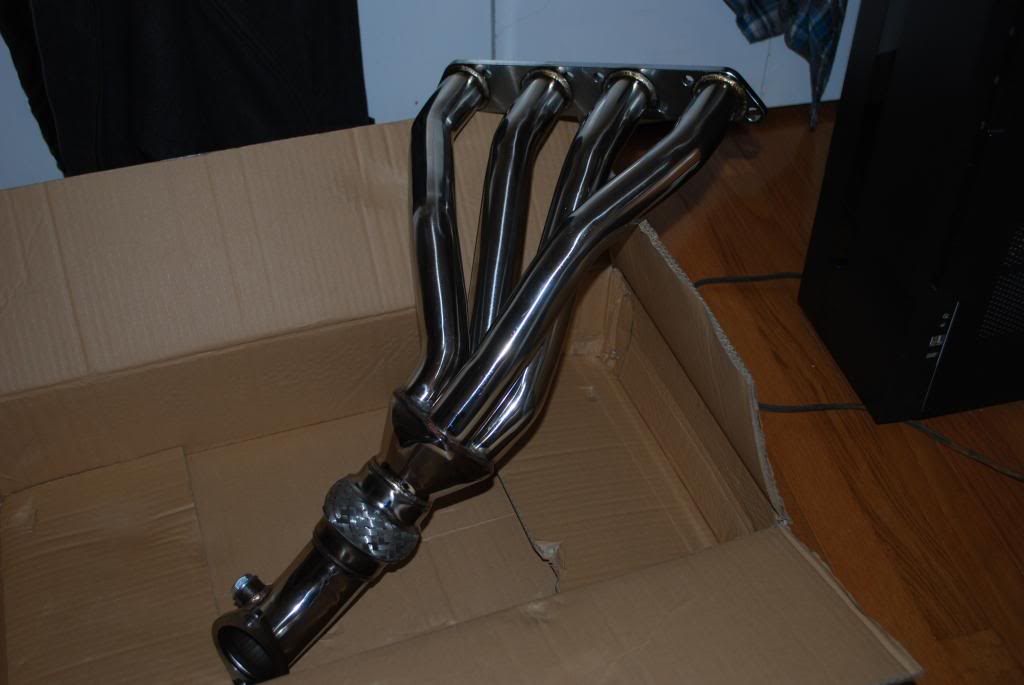

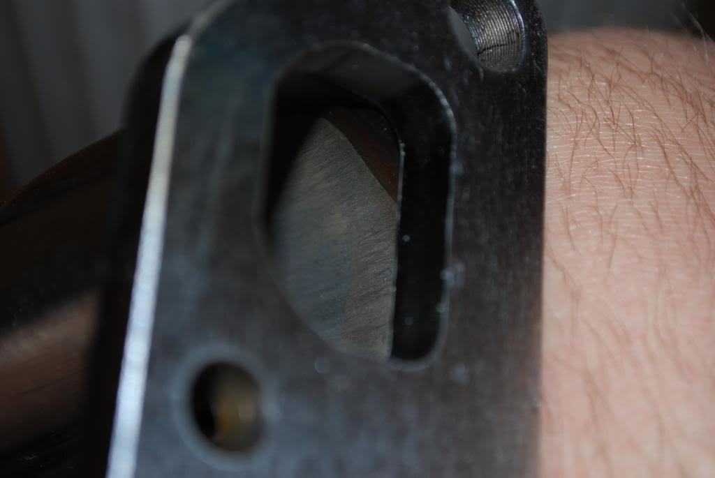

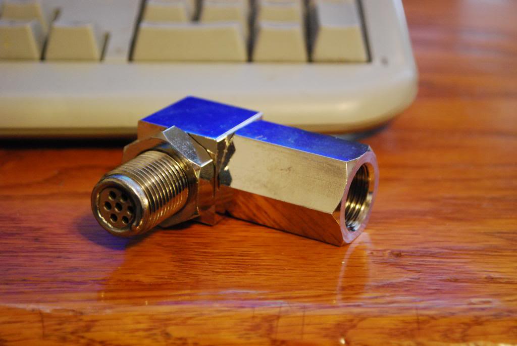

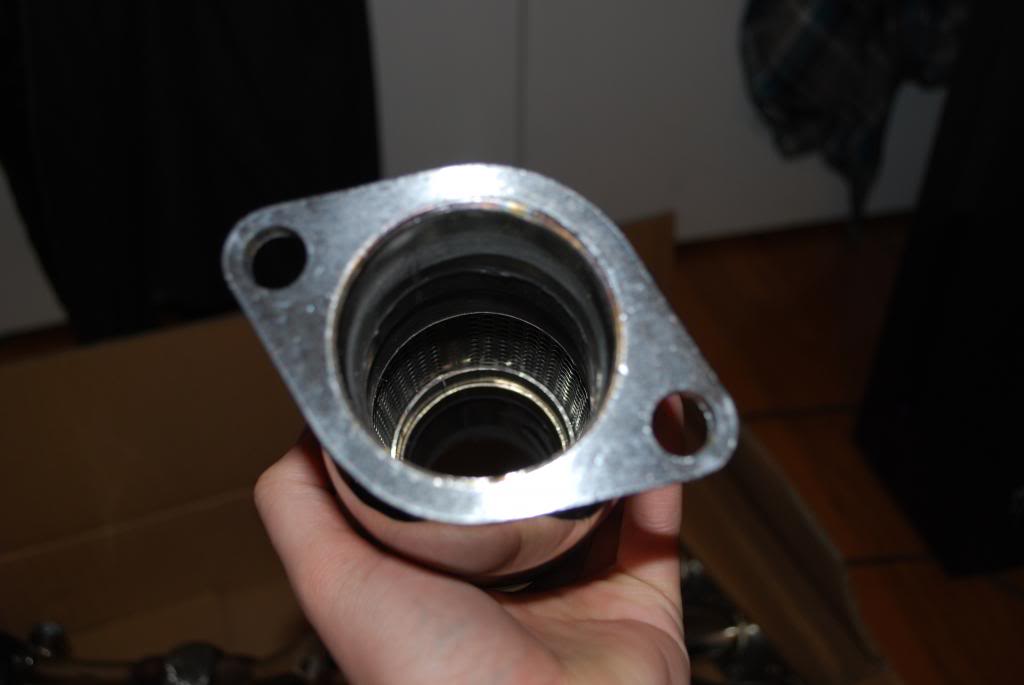

as pointed out by another member, to me becasue i just got a megan/M2 header from outmotoring. any one have this issue?
Originally Posted by SniperDetailing
Make sure you bolt that header up to your head before you do any coating. I ordered one off ebay that looks exactly the same down to the o2 plug-bolt and there were 2 or 3 manifold bolts that just wouldn't line-up at all
also anyone have issues passing emissions at all? i got one one those o2 spacers with the catalytic material in side if it so hopefully it wont through a code.
edit: also when did they update there headers? the test pipe section looks different from everyone else. you think they fixed the crappy resonator?
