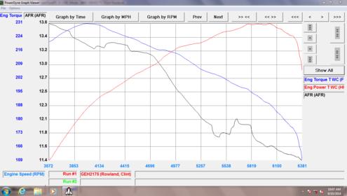

Here is my pull from the dyno today. They put 2006 but it is a 2007 in the description.
Stage 3 Tune
218WHP
233WTQ
76f humidity 74% 1033ft
As for boost my Vacuum gauge showed 18-19psi max.
Attached Thumbnails Battle/DNA Tune Thread-mini-cooper-run-2.jpg   Battle/DNA Tune Thread-mini-cooper-run-hptq.jpg
Stage 3 Tune
218WHP
233WTQ
Nice for a 07 MCS, nice to know what I can expect when I tune my MCS. Have you ever performed a compression test before on your engine?
No i haven't. I have one some where in the garage from my mustang and DSM days.

When does your MCS cut boost, 4500 rpms? My 07 MCS loses most of it's boost at 4500 rpms and was just wondering if yours does lose boost at 4500 rpms. We have the same engine and same turbo.
My boost stays around 16-18 until 6,100. i will try to take a video and im waiting on my obd2 Bluetooth so i can do some logs. And what im reading my boost from is a vacuum boost gauge i installed. My scangauge seems to read much lower but im going to look into making sure i have it setup correctly.
If you're right about the boost being 16-18 psi until 6100 rpms it seems the tune might be responsible for you maintaining boost till just under redline. My Mini is in the body shop right now, bummer because I just corrected the altitude for my Torque App, oh **** I left my MX Bluetooth hooked up when I dropped off my Mini! I'm going over there now to grab it, while I trust them to do an excellent job you can't trust the entire shop personal, I want to see how there doing anyhow.

Originally Posted by cerenkov
Is your scangauge have the specific programming for MINIs?
Yes I got the one programmed for the mini and the weird thing is with the car off and ign on BST shows 0 on the scangauge.
But the scangauge and my vacuum gauge are off around 4-5psi. (Scangauge lower)
