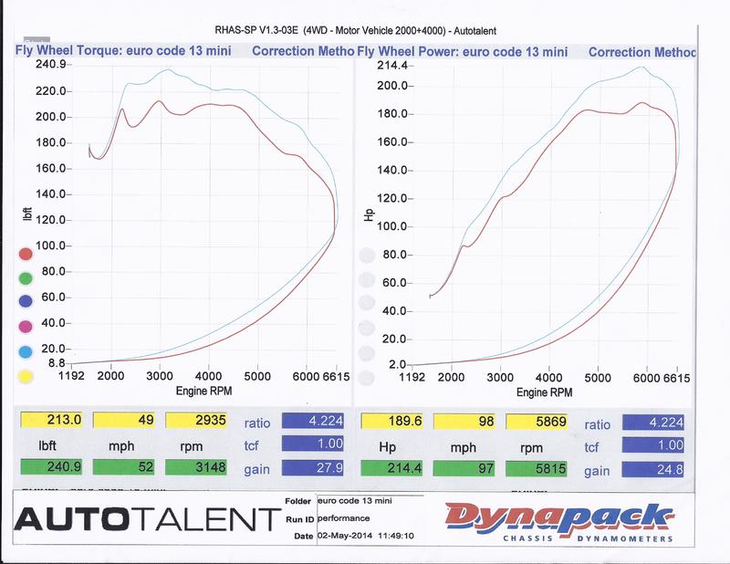

Sorry for the delays. You can see in my attachment the dyno chart. Ignore the sweep that the graph does. You can see above 5k rpm it still has life in it. Pulls all the way to redline when I drive it. Realized I was not running the correct spark plugs with the proper gap that Nick wanted. He said if I got the ILKR8E6 or DILKR8B6 plugs I could have gotten a lot more power. Also I filled up at the cheapest gas stations I could find and the gas was not very great during the tune. Nick says the numbers could have been a lot higher. But it is still high as it is.
214.4whp and 241wtq on a Cooper S turbo. Not bad if you ask me. The top end has a lot of life compared to when I had my JB+!

The dyno was with 91 octane.
Today I mixed 91 with 2 gal E85 and wow you can feel a huge difference. I wish I dyno'd with an E85 mix. Numbers would have been a lot higher.
