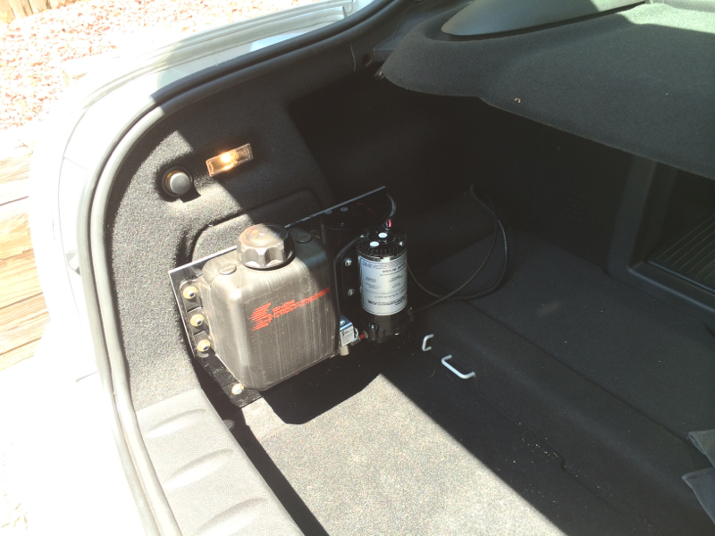

I paid $370.00 last year.- snow performance boost cooler kit 20010.
I like it. I just needed to get longer tubing and some electrical wiring because I installed it in the trunk. You would need to come up with a way to mount it.
I bought the snow performance safe injection and the flow gauge to add to my snow performance kit (20010) the guage will only work when connected to the safe injection.
The safe injection installs easily inline (tubing). And wiring connects to boost controller and guage.
Yeah, the gauge is cool. You can choos blue or red light

Here is the install in the trunk, I got a piece of black lexan to mount the tank, solenoid valve and pump.

I just got back from a test ride. I turned down the pressure on my pump a few times, now I'm flowing right around 500ml/min I guess I don't need to install the 441ml/min nozzle. I also ordered a 1 gal fuel cell from summit racing. The Snow Performance kit comes with a 3 quart tank. The 1gal tank would last a bit longer. Plus it has a separate vent fitting. Sent from my iPhone using NAMotoring
