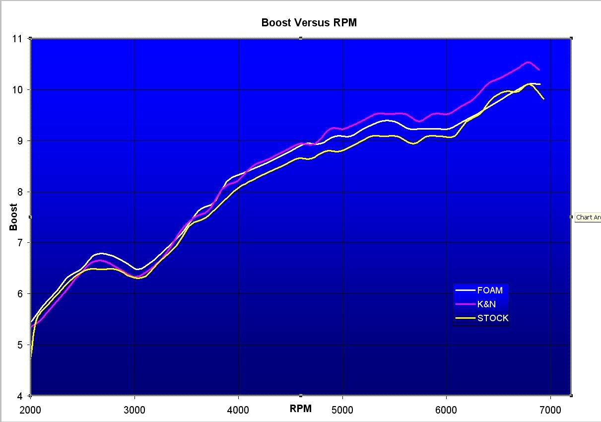

Stock is stock, K&N is the filter discussed earlier, and foam is foam filter similar to the alta but MUCH smaller mounted directly to the TB. This was the biggest foam filter I could fit on the TB because the foam guys dont make oval filters like the K&N.

Thanks Macncheese, exactly what I was asking about. HAI with RU-1550 it is then. Apologies if your chart was already in the thread...I have read it and couldn't recall seeing such a chart.

wow. i'm surprised at how well that dinky little foam filter did.
i went to the uni filter site, and they had a couple filters that may work pretty well.
But really, if the foam filter was bigger, i wonder how much better it would do... hmmmm....
I have two boxes of unifilters from when i was developing the intake. and the problem is that thats the biggest filter that will fit there! They do have slanted foam ones that may be bigger and work better but the K&N is cheap and readily available. I waited weeks for the filters from Australia. I'll dig them out and see what I have available.

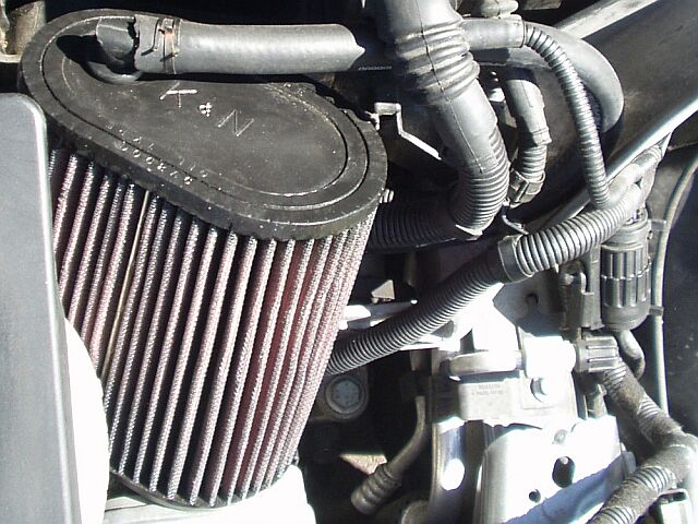

My HAI is now Emissions-Legal
Yesterday, I installed an elbow on my K&N filter and plumbed a section of 1/2" ID heater hose from the driver's side valve cover into the elbow. Here's a quick pic:
This does away with the breather filter that I had and allows the crankcase vapors to enter the intake system, as they do stock. The elbow and the hose were about $3 each at the local Pep Boys.

I was thinking of doing the same thing, but am wondering if it could be done from the under side? I think there might be enough room. has anyone tried this?

Andy: looks like you cut that tube by chewing it off

Andy, for people with oil catch cans installed, would you use that tube to provide suction for the catch can?
