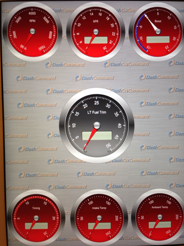

What else should I be looking at? I believe I have all the important ones.

I also watch my coolant temp. No use doing logging runs if you aren't up to temp as the DME limits boost in that case.
For fuel trims, they constantly adjust to give you the correct amount of fuel based on the fuel you use and small differences from car to car. As long as they aren't maxed, you are ok. They get maxed when you add e85 (lean it out but raise octane) and the jb+ (lies to DME in order to raise boost) and the fuel trims are used to adjust.

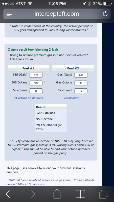

Found this helpful site.
http://www.intercepteft.com/calc.html

Thanks. The calculator at the bottom of the page is really helpful

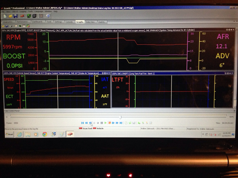

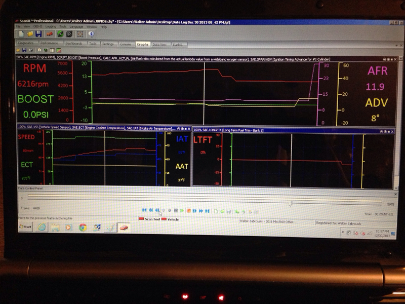

Burger Motorsports (BMS) Tune(s)-image-2270184038.jpg Burger Motorsports (BMS) Tune(s)-image-2474366271.jpg Couple of logs from tonight. Everything appears to be good at 2 o'clock with the roughly 30% E85 mix. Someone mentioned to keep an eye on the long term fuel trim and that appeared to hover around 0 to -5 if that makes sense. Anyone that could help under stand the readings on that would be appreciated. Disregard the missing boost reading.
