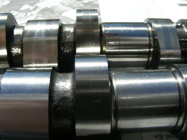

I have a photo of an OE cam in the first post, for a close-up look below; NitroStick in the foreground and stock behind it.

How does a cam break during shipping? Was the box broken also?
Not sure why it breaking in transit is any better then breaking while in use.
Honestly, I'm really surprised that anyone would put a cam like this in their car. It's unfortunate that some here can just say the "Oh well, who cares what it looks like" thing. Are we all now just to expect low quality just because we have been "told" not to worry about it?
Come on people, start demanding the quality that you have paid for. I can't believe someone would want associate their company name to such a thing.

This thread is supposed to about the re-grind, but I know a few things that address this side issue. I received a Newman camshaft from RMW a year ago with very rough as cast sand features, and run-out on one lobe, edges worse than the example show above, Partsman posted a copy of one of my photos earlier. I sent photos to an engineer who is involved in engine failure testing for domestic auto manufacturers; he also presented the photos to other professionals including a camshaft engineer. None of the evaluations were flattering, but none said functionality could be determined by appearance, all called attention to the possible crack inviting stress risers at the undercuts and sand cast features on the lobe edges. The camshaft engineer added this comment, “If the manufacturer thought that was OK, then what other shortcuts were taken in the manufacturing process?” Keep in mind my example had larger grain features than those in recent photos, the blank was black, and it lacked markings seen on other Newman camshafts I’ve had in my hands, FWIW. The latest double inspected Newman cam I installed has greater attention to detail, and much tighter grain texture; the vehicle in which it is installed idles and runs very well. After experiencing a faulty grind it makes me wonder if the many other Newman camshaft owners who have idle issues after installation may have a less than accurate grind, especially since the latest install I performed idles right.
About the broken cam example, because of the blank casting process I would venture to guess it was a foundry fault, and because Newman is a relatively small company they lack the resources to inspect the blank metal’s integrity. The company is a business and therefore must make a profit, to do that they must seek low cost foundry services, most likely offshore. India has blank casting foundries for example, with a foundry far away (example), it is difficult to exert control over the process. Here is another broken in transit Newman example http://www.750formula.co.uk/forum/vi....php?f=4&t=189. Although a non-MINI, it shows the likelihood of a casting void failure. Notice how the lobe edges are not like the bastard child treated MINI’s.

Originally Posted by Thumper460
Did you check the dimensions/measurements against that camshaft?? ... I would be more concerned on the way that money was spent.. vs the ruff core and lobe sides.. or a regrind from one of the top cam grinders in the US!!
Thumper
Does Newman even supply the cam card? And about the, "vs the ruff core and lobe sides..." I think onasled kinda adressed that in this statement, "Come on people, start demanding the quality that you have paid for".
