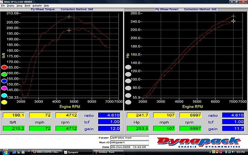

Blimey... you Rock!!! I agree, the advantage to the majority of the drivers is HUGE!!! And with the added advantage of the cost, it is well affordable!! Yes??
Have fun.. and document... document... document... LOL
Just me....................................
Thumper
PS: Dynojet results: 10 WHP off the bottle and 12.4 whp / 21.36 tq diff on the bottle!! ( 257whp/260 tq)

let's educate the masses here
Thumper........here are your 2 runs
the first without meth..... note the a/f ratios running down to as low as 11:1 which is very safe
the second run you were running lean at over 13:1 in places
this "lean" condition will net you a phat dyno number but in the end... plan on rebuilding your engine after some heavy track abuse
Attached Thumbnails Devil's Own Water/Meth-thumperun.jpg

bottom line: 10 WHP on an UN-tuned 06!! No issues/ no engine lites..
go figure....
Thumper

I'm saying it isn't safe, if ignorance is bliss then you should be feeling mighty good right now
here is a run in 90degree weather
NEVER was safety given up for hp here

Why on Thumpers dyno didn't he gain any torque? The graph I showed picked up 12ft lbs of torque in the area where you drive it . Area under the curve is where it's at

Where is the A/F on this dyno sheet so we can compare?
Nice gain thats for sure, what spec is the engine?
What real world performance gains do you see big howe ET wise?
Attached Thumbnails Devil's Own Water/Meth-meth.jpg

17% pulley
RMW HEAD/CAM/ RACE HEADER/Exhaust
440cc injectors
RMW TUNE
RMW METH KIT
91pump gas
I can guarantee you it's under 11.5 a/f ratio up top
I'm not going to give out our secrets to our competitors so they can cut their tuning times
