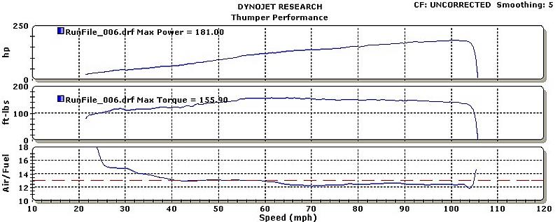

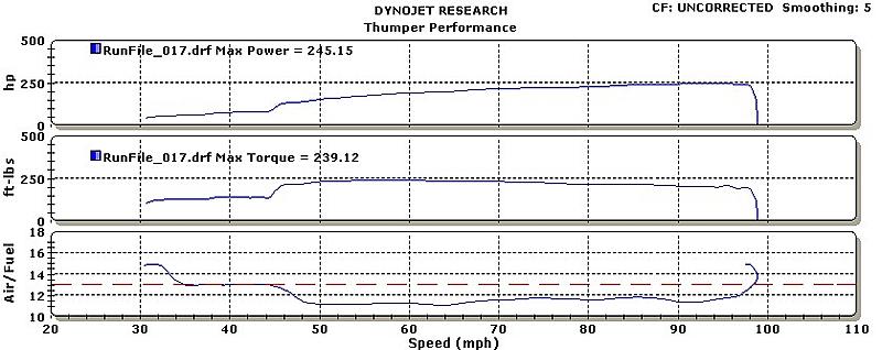

The w-m system is a good one, I know a few running them. I have the snow performance with their "varie boost control", pulling the pressure from my boost gage / reg pressure line. seems to work great!! I have it spraying in after the I/C and the results were pretty good!! 10 HP gain on a 30% mix, and then on the bottle I pulled an additional 12 HP and 21 tq on a 50% mix!!
I should think it is a great system.. esp if you dont have any tuning capability.

Nice gain with the meth system.

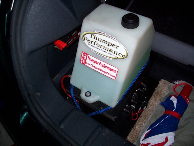

Very Impressive...and yes, I am on/will be on a stock tune...wheres the tank?

I elected the 2 gallon res and put it on the boot!
