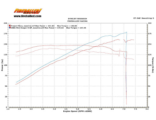

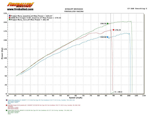

Baseline testing on stock vehicle yielded 169.47WHP.
As a reference, we included data from a MINI GP which made 178.48WHP at 7100 RPM.
The stock vehicle made 158.40WHP at the same RPM point.
Next, we replaced the stock cylinder head with our Fireballed! Stage Three Race Head and returned to the dyno a few hours later.
With only a cylinder head change, "MARY" mustered an incredible 202.98WHP at redline which equates to a whopping 33.51WHP increase!! in peak WHP.
As a reference, using the GP data at 7100 RPM:
stock mini: 158.40WHP
stock mini GP: 178.48WHP
stock mini w/Fireballed! Stage 3 Cyl Head: 196.36WHP
An incredible 37.96WHP increase with only a cylinder head change.
To our knowledge, we believe this is the most peak WHP a stock MINI has ever made with just a cylinder head change.

What RPM was used to compare?
Why that RPM?
What was the RPM limit increased to?
Would it be possible to overlay the RPM on the graph please.
From the graph it looks like you could have chosen a slightly higher RPM to acheive an even greater delta.
Why that RPM?
If you see the black line going from bottom to top this is where the GP rpm limit kicked in.
Why that RPM?
Thanks for sharing your research.
The RPM was increased to 8200.
I appreciate that you have the insight to see that this is not about choosing numbers to show the largest deltas. We used the GP redline just as a reference point. Unfortunately, the tach pickup was acting up at high rpms, but i will post rpm graph and torque data.

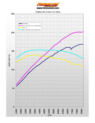

DYNO DATA/PICTS OF STAGE 3 HEAD
Stock baseline vs. MINI GP
Comparison of WHP and TQ data between stock baseline and stage three head.

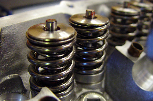

Custom valvetrain built to our specifications by Supertech Performance.

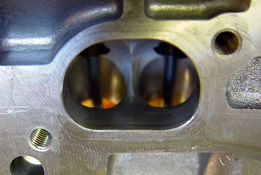

EXHAUST PORT

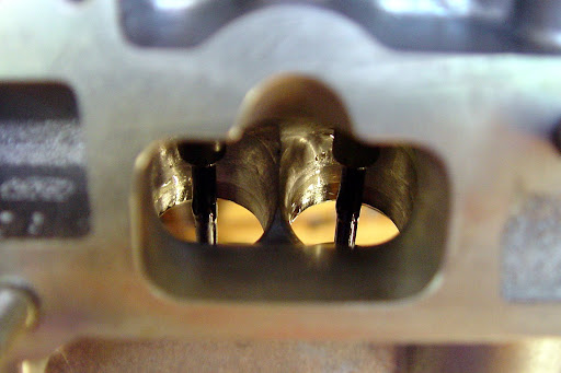

INTAKE PORT
Nice work Hubie and Brian. Keep the good news comin'.
