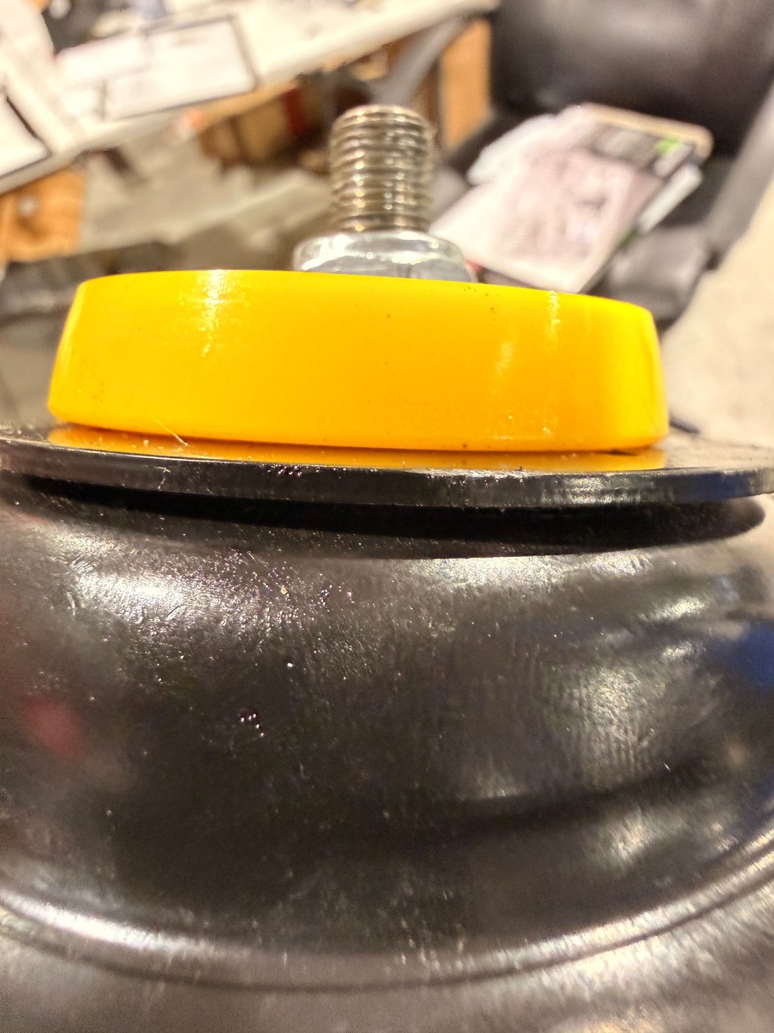

This is a view most probably don't see. I've been relentlessly chasing a knocking/rattle noise in the rear of my Countryman. Everything in the rear is new. Shocks OEM, Springs, insulators, trailing arm bushing and brackets, control arm and upper mount. The top nut was tight when assembled but as you can see with weight on it, the top bushing is no longer compressed and is separated from the top plate. The video links are the movement while driving over a rough road. I cannot figure out what the issue is. I've got about 50 hours in this battle and finally ripped out the side panel to get a bore scope in there. There should be a solid stack from the lower beveled washer and the top inverted washer. Yet there is space. tell me if you agree this is abnormal?

I sent this to Detroit Tuned since I bought my NM swaybar and end links from them. He told me the while aftermarket bushings don't work and all crush down like this. He recommended Powerflex bushings so that's next.

Unfortunately, yeah, that's normal for aftermarket rear bushings. Also unfortunately, the OEM bushings only come with new rear upper mounts.
Are you getting a clunking noise from the rear? What made you decide to stick a camera in there?
Poly bushings in that location will help with the shock doing its job, so should add to better rear suspension control.

Yes they all will mushroom more or less on the rear shocks from R50-R61s. Weather, condtions, and weight on the suspension also play a part. The design of that top mount tends to sag under load. When you have a lowered car or coilovers it seems to kill them faster. I have seen some last a while aftermarket and some just fall apart. You can get the foam part with tube washer on its own.
The factory MINI ones do this also over time. Early designs of the Genuine MINI factory part had more elastic in the foam mount (took a long time to fail on my 2005), they were made by lemforder for the foam part, then about 4 years in the changed ~2009 the design to more foam and less elastic. Then they tend to fail and mushroom down and clunk over bumps as they have deformed and dont bounce back.
I went to poly on my coilovers as i drive allot from PSB or Powerflex.
PSB: https://www.ecstuning.com/b-psb-part...t/psb664k~psb/
Powerfflex: https://www.ecstuning.com/b-powerfle...fr5-115x2~pfx/

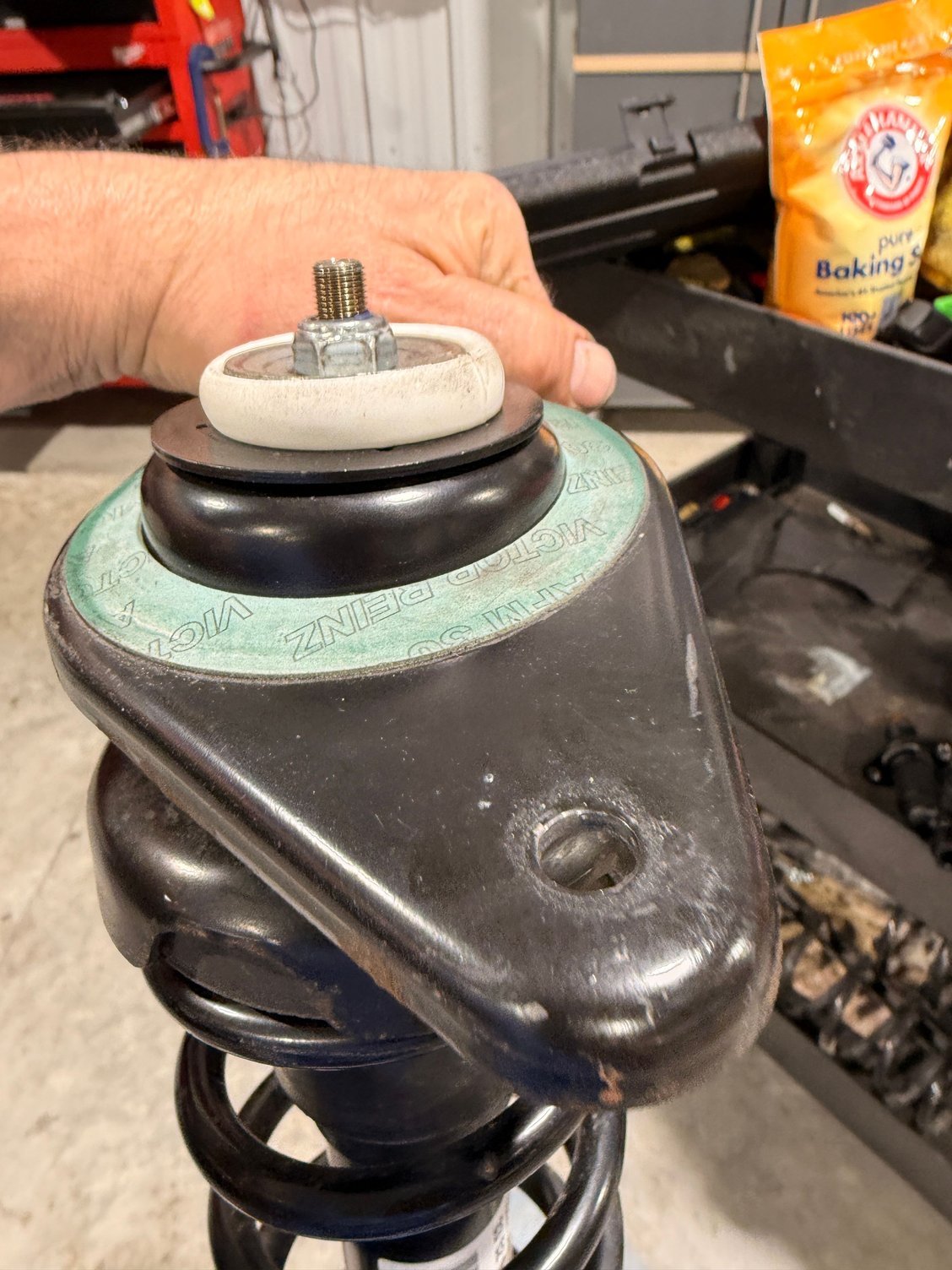

yes I have a bad knocking in the rear. I originally just replaced the shocks as they were dead. I can’t remember if I has the clunk before or not. I have so many hours into searching for this noise. I went back and replaced everything. No change. I ordered a different t set of kyb mounts. No change. I took the strut apart so many times I stripped the Alan key at the top of the rod. I then bought oem shocks and lemforder top bushings. Same.
so yes I pulled the side panel which is a pita to look down at the top of the shock as installed and found this big gap. Keep in mind these are new. You can see the big gap between the perch plate and bushing. Here is a picture of what it looked like when I installed it. Nice and squashed. Now not so much. I pray the power flex fixes this issue!

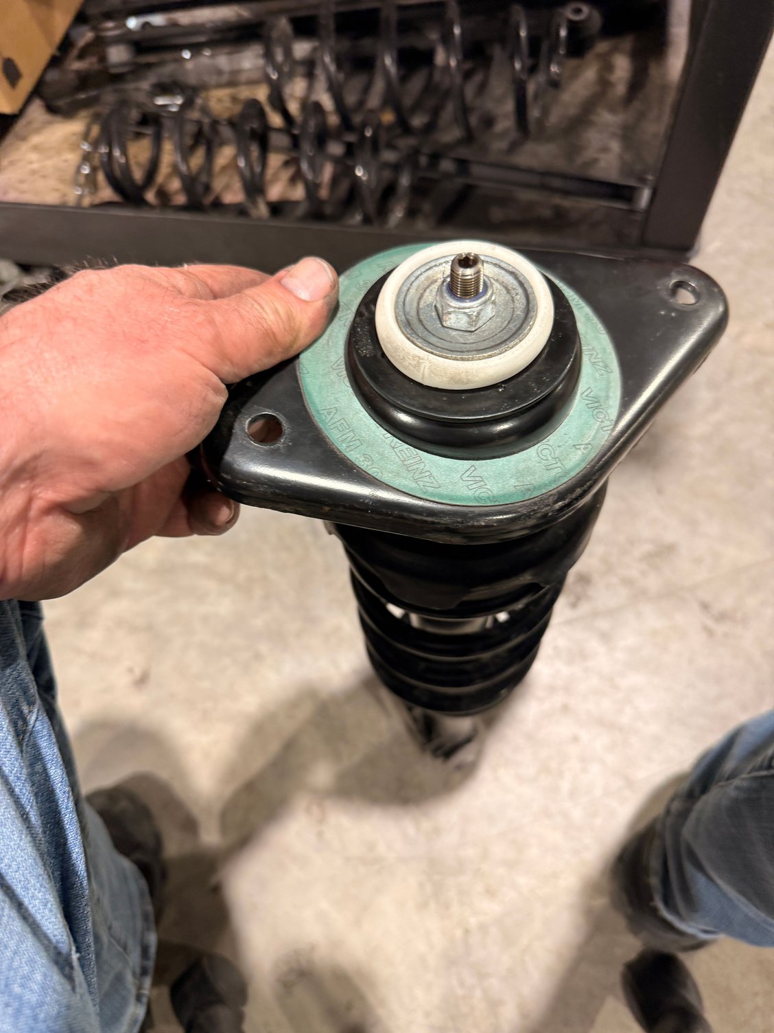

ECS, I would have gladly bought the OEM mounts if plates with the bushings had I known the aftermarket ones are such trash. I figured the Lemforder ones were the same as OEM. I’m so tired of aftermarket crap! I need a break and to put this thumping issue to bed.

Lemforder is the same, MINI (Genuine) changed the materials and all the aftermarket ones followed, they all used to have more rubber or elastic material with the foam. I have old ones (2005 built) that lasted maybe 60K and needed replaced, my new ones were a different material and they were genuine.

what I don't understand is that it's not like these have 30,000 or 60,000 miles on them. They are new and the bottom mount is smashed so bad there is a big gap at the top. When I take the strut off, it will puff back up and look normal and the nut will be tight compressing the metal tube from the bottom washer to the top washer. How can they even sell these?

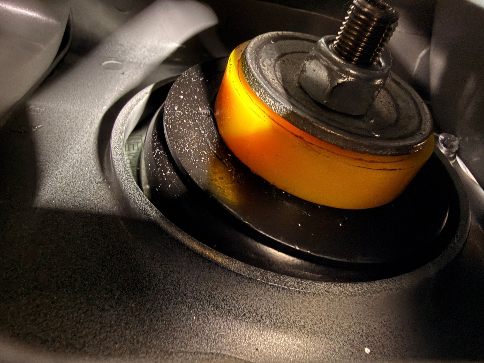

Soooooooooo, it hasn't been that long and my noise is starting to return. Nowhere near as bad but I hear it. In goes the borescope again and sure enough, I'm having alot of movement in the shock top and the preload on the top bushing is gone. The only thing I know to try is to shorten the metal sleeve that is 30mm long and grind off a mm or so. This is the only way to increase the clamping force on the lower and upper bushing as the lower bushing compresses a bit with the cars weight on it. I can't find any references that someone has done this or needed to do it. Shortening the sleeve will reduce the stack height and increase squeeze on the bushings.
I disagree. Shim it. A few washers between the nut and the metal collar should provide extra downward force on the bushing.

the metal sleeve dictates the distance. You could add a washer under the cupped washer but the ID would have to be larger than the sleeve but you would loose the cupped effect if I’m explaining it clearly enough. I ground the sleeve 1mm and there is more pressure on the bushings now.
Ahhhh...I think I know what you mean. The unthreaded part of the bolt (or in your case I think "journal" would be more accurate) is called the "shank." I think this is what you mean when you say "sleeve," correct? Seems you have found a workaround for my "shim" idea.
Keep us in the loop. Let us know if your fix is permanent or not. I appreciate your diligence on this repair. Good stuff.
