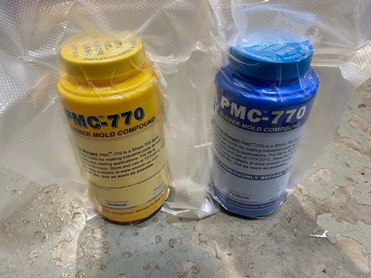

To remedy this, I unfortunately haven’t found any aftermarket polyurethane mounts or stiffeners, so this means I’ll need to do some custom reinforcing.
For the front bushing, I’ll be using a new factory MINI mount, filled with Smooth On PMC-770 liquid urethane rubber mix. A 70 durometer two-part urethane system. I’ve used the PMC-780 (80 durometer) on bushing with much success in the last. More on this in a later post.
As for the rear mounts, my first idea is to look at the R60 Mount kit from Powerflex. The factory R60 mounts look very similar to, but not exactly the same as, the F54/60 mounts. They also look very similar in size. I have a couple messages in to Powerflex and other companies to try to get the dimensions of the R60 mounts, hoping they’ll swap right in. Here is the Powerflex PFR5-1825 kit for the R60.
If those don’t work, I’ll be filling the factory mounts with Smooth-On PMC-770 too.
More to come….

I received the dimension for the R60 Countryman rear bushings from Powerflex. They are very similar to the measurements I took on the F54. I think they might work on the F54, but I had Smooth-On PMC-770 ready to go so I filled the rear factory mounts with it.
I was going to fill a new forward mount but it’s currently backordered. That be another day.

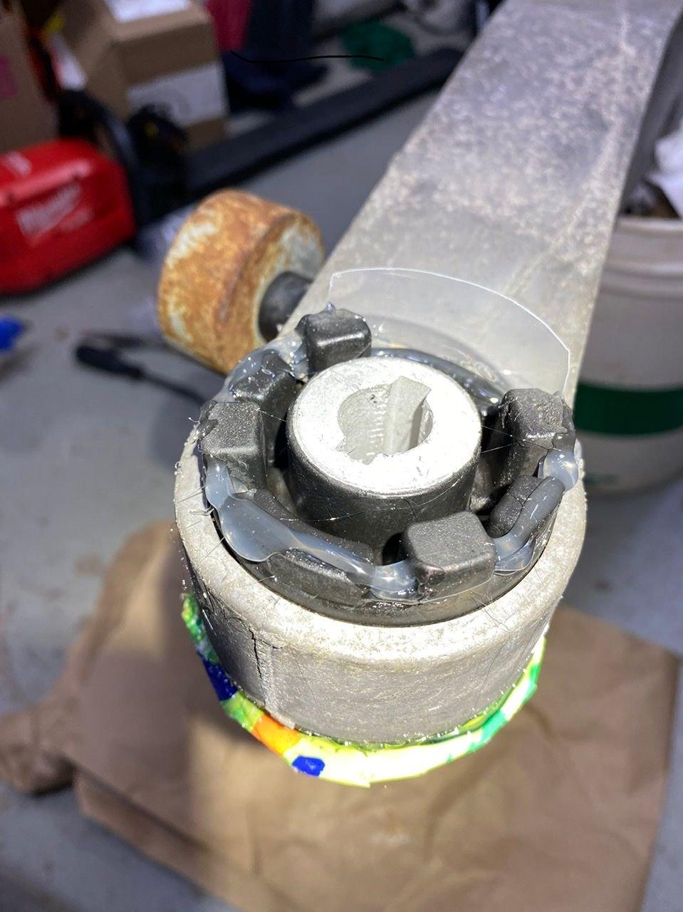

After removing the rear differential carrier (easy, just a 16mm socket) I thoroughly cleaned the rubber mount then started sealing one end of it up to pour the urethane rubber mix in. Mostly just hot glue and a cereal box 😄.
Mix the product as directed and pour into the voids. Pot life on this is 30 minutes, but after 15-20 minutes it’s getting pretty thick. Here’s the mount after about 12 hours of cure time and the hot glue molds removed. Not pretty, but 100% functional.
Then I did a little trimming and cleaning up the new urethane and reinstalled the rear beam.

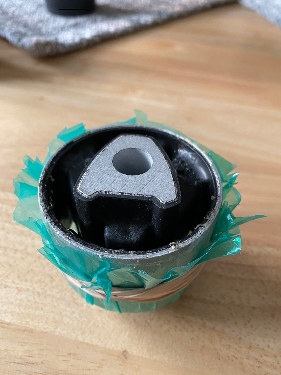

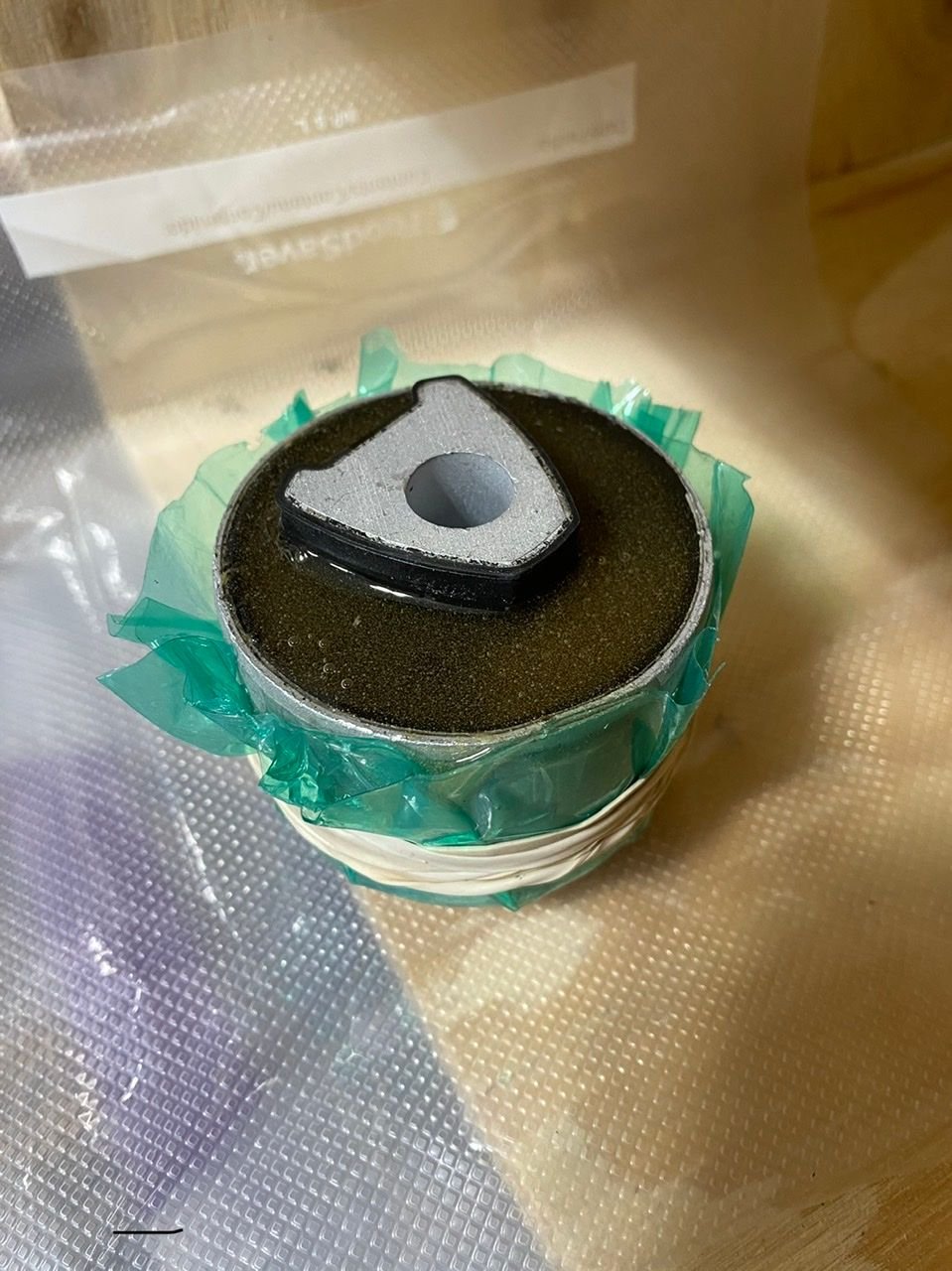

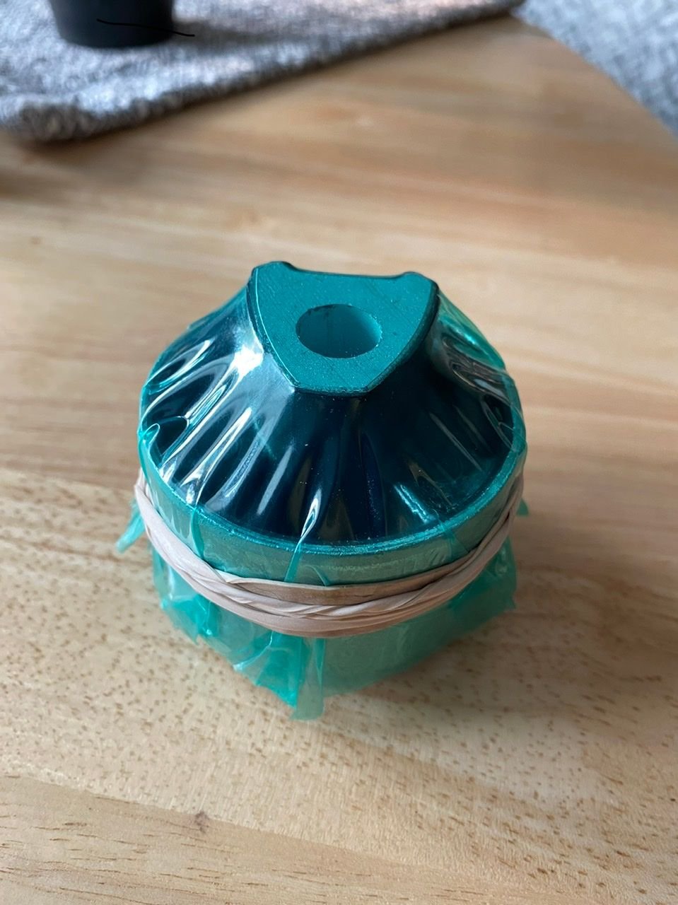

I made some progress on the forward differential mount. I sealed one end of a new bushing with some floor protection film. It has a slightly sticky back with a light, removable adhesive. It’s essentially vinyl wrap film, which should also
work great if you have scraps around.

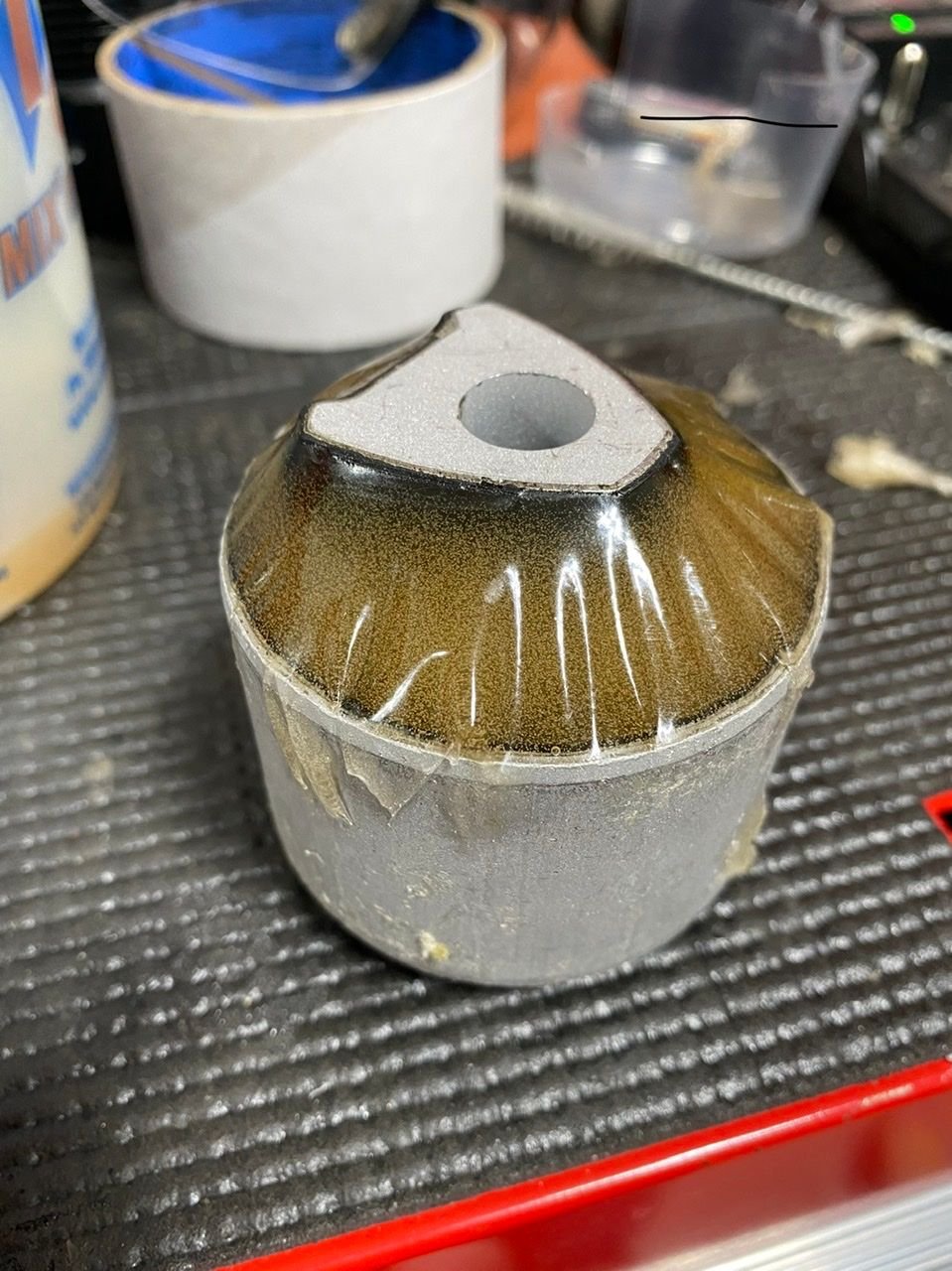

Fill it with Smooth-On PMC-770, let cure, then remove the the film.
I’m super happy with how it turned out. Next challenge will be installing it.

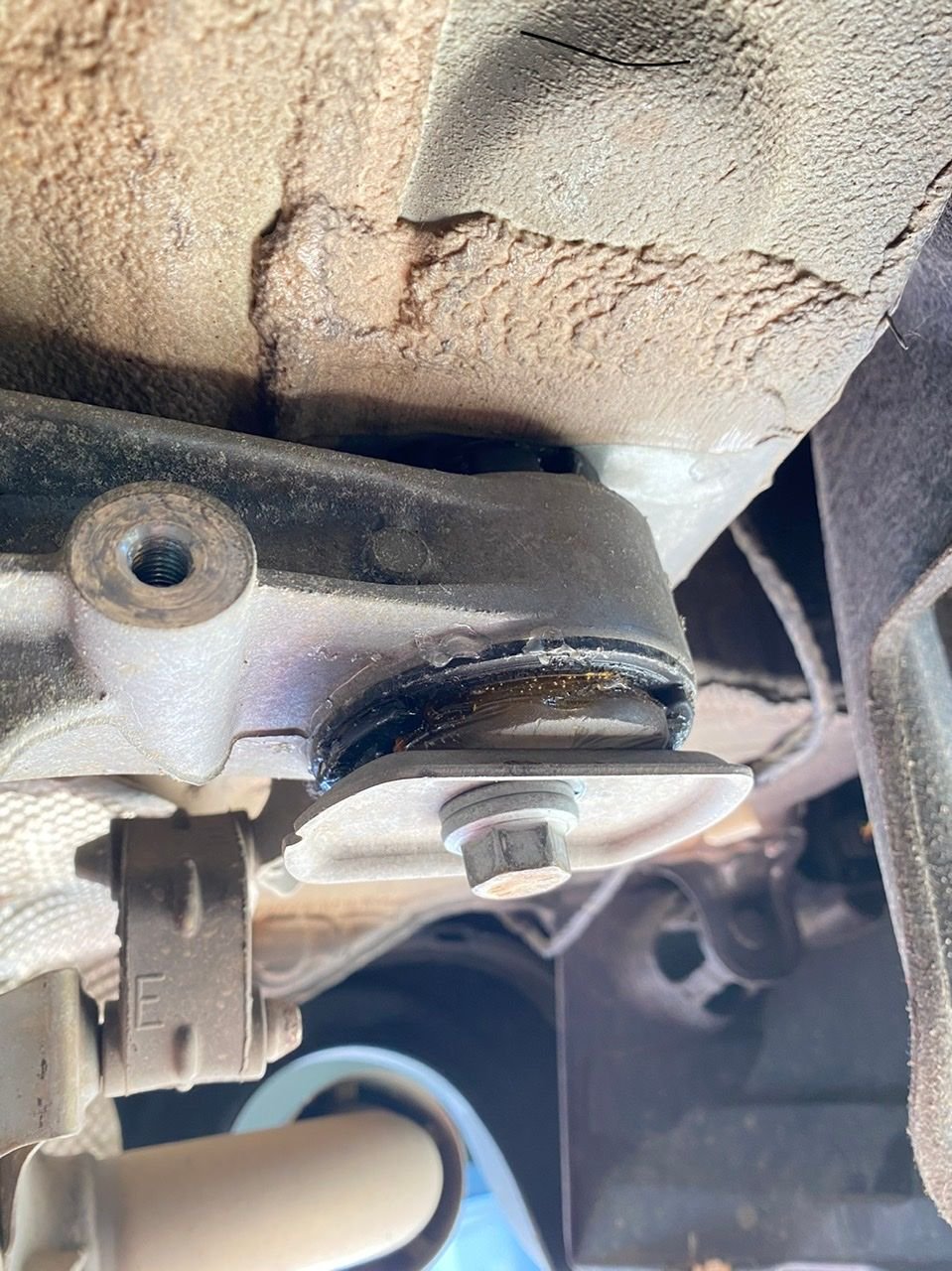

Got the modified forward bushing installed. Not terribly hard, but you do need to drop the exhaust, unbolt the driveshaft from the differential (3 bolts), and lower the differential about 12”.
My homemade bushing press tool had a hard time getting the bushing out (my fault - didn’t get hardened threaded rod), but the new one went in fine coated with anti seize. The bushing shell is aluminum, so cutting the rubber out and using a hacksaw to cut the old shell worked well. Then hammer the old bushing shell out.
I’ll update this once I get a chance to drive it more.
