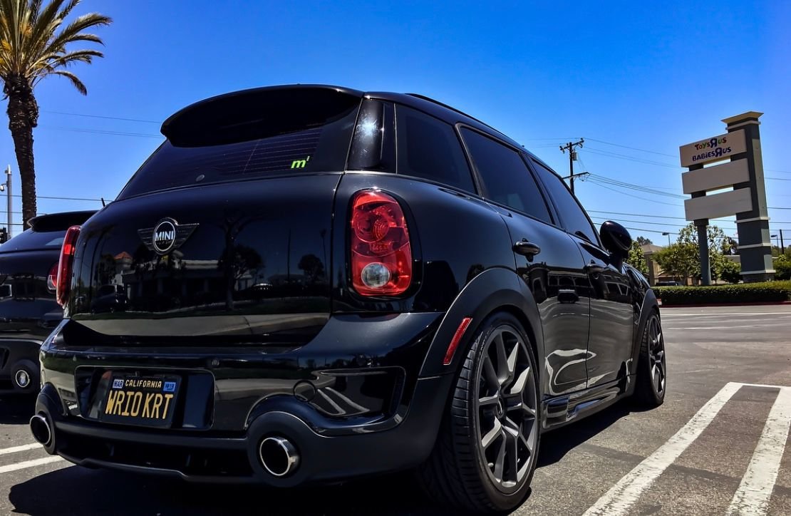

Manual AWD Countryman are a horrible is first gear. The little 1.6 has a hard time moving it off the line. I went with lighter 19” wheels, Sprint booster, and stage 2 Tuning. Tuning changes it a ton.
I did make the mistake of putting too light is flywheel, it’s so light it can keep it self going.
