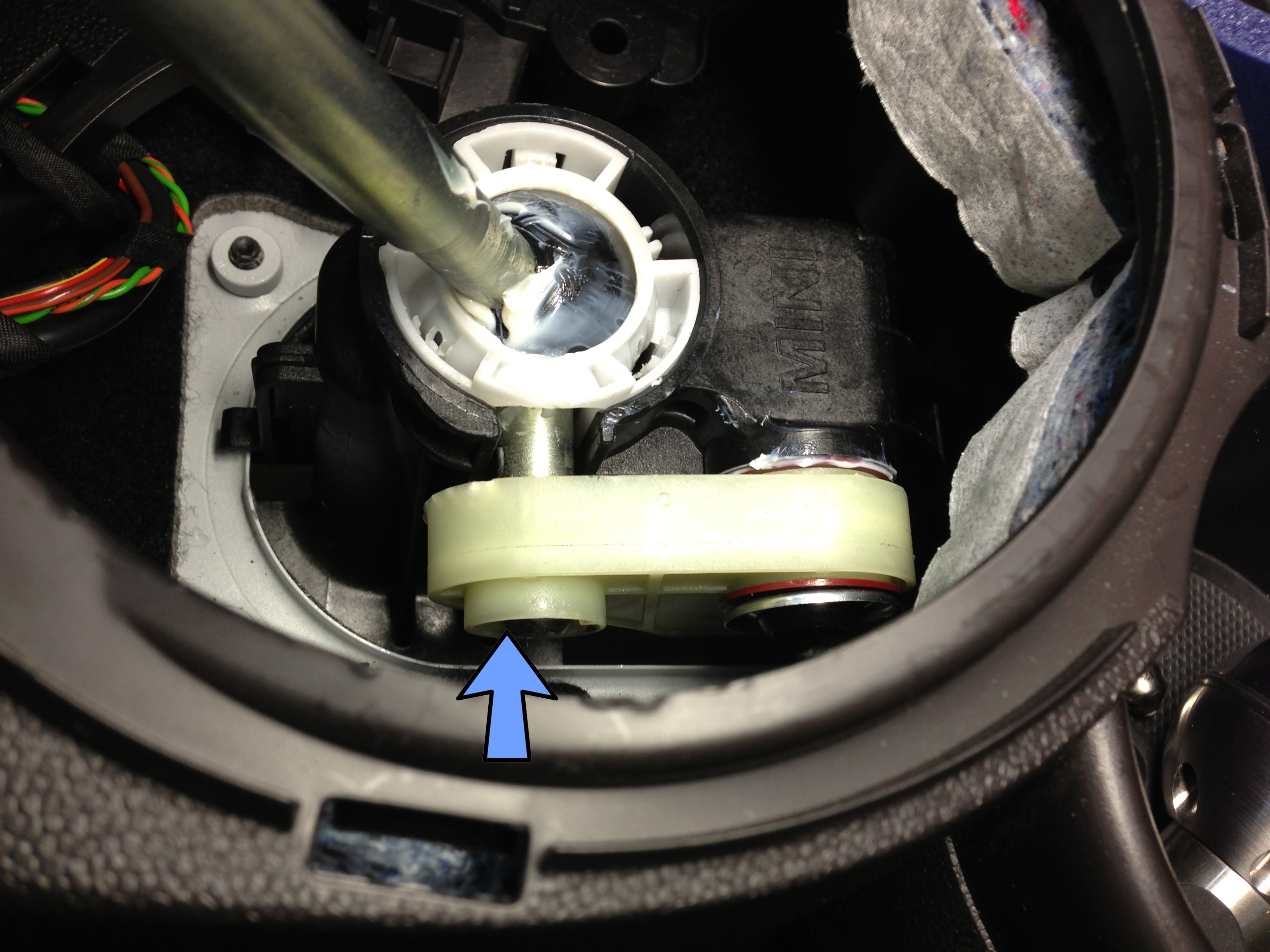

Need immediate HELP from manual transmission Countryman owners! took countryman to dealer today and when I got car back my manual trans feels different. when its IN ANY GEAR the stickshift moves around a few centemeters side to side and a bit forward and back. I remeber it being in gear and not moving very much!
Please anybody with a manual Countryman go and check yours for me! Put it in first gear and see if the stick shift wiggles and moves, and if so how much! I want to know before I have to call dealer, thank you all!

It sounds like a bushing is missing. The one in here, where the blue arrow is pointing. In the picture, it's missing. It's hard to tell because it's next to impossible to get the camera in a better position. Hope this helps.
VERY interesting indeed. Mine is 2015 with 8000 miles so not sure how that could have happened. Is that something I can replace? I think if more kind people help me out and take a moment to look at their own manual countrymen and post on here we can figure out if its "the nature" of the way this car was designed, or if there is in fact an issue unique to my car.
