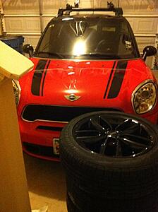

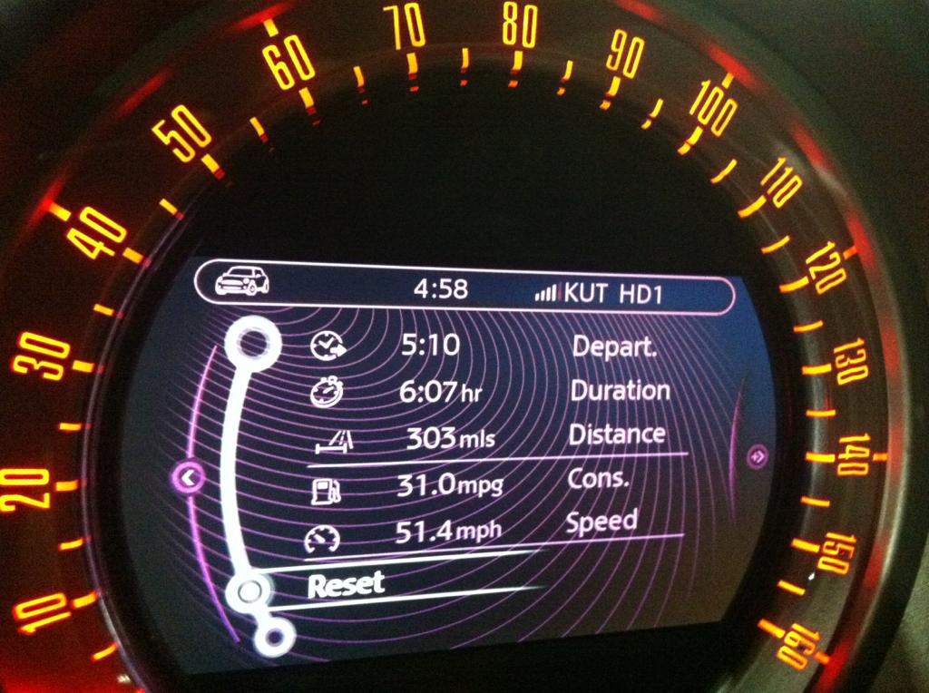

I run my RF at 40 PSI, noise gone and I get on average 29-34MPG.
Before you make any opinion on getting rid of your RFs, check out the videos on youtube. There is a reason the Germans (BMW) have put RFs on all their cars, it's safer than regular tires, also safer than using donuts (half tire spares).
I had a flat for two days, I drive between austin and san antonio (couldn't make time to get it swapped out).. Countryman ran heaver and I pushed it past the 50mile recommended limit, but two days and over 200 miles on a flat - no damage to rim.. no blown tire, no changing on the side of the highway..
Only negative was the hefty $425 from MINI of San Antonio to replace (no one else had my tire), but future solved this by buying a full set of brand new rims/wheels on ebay for $1k (heck of deal). So if I get flat in the future, I'll buy the wheel on the internets for $220 (confirmed price), have it mounted for $25 (confirmed discount tire).
