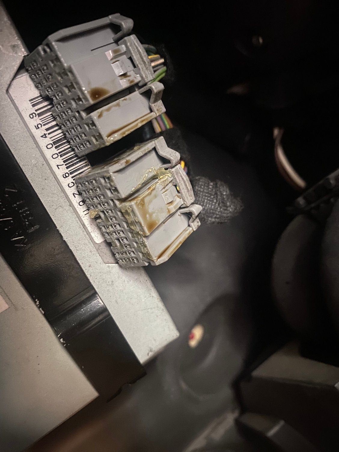

Old May 24, 2023 | 04:58 AM

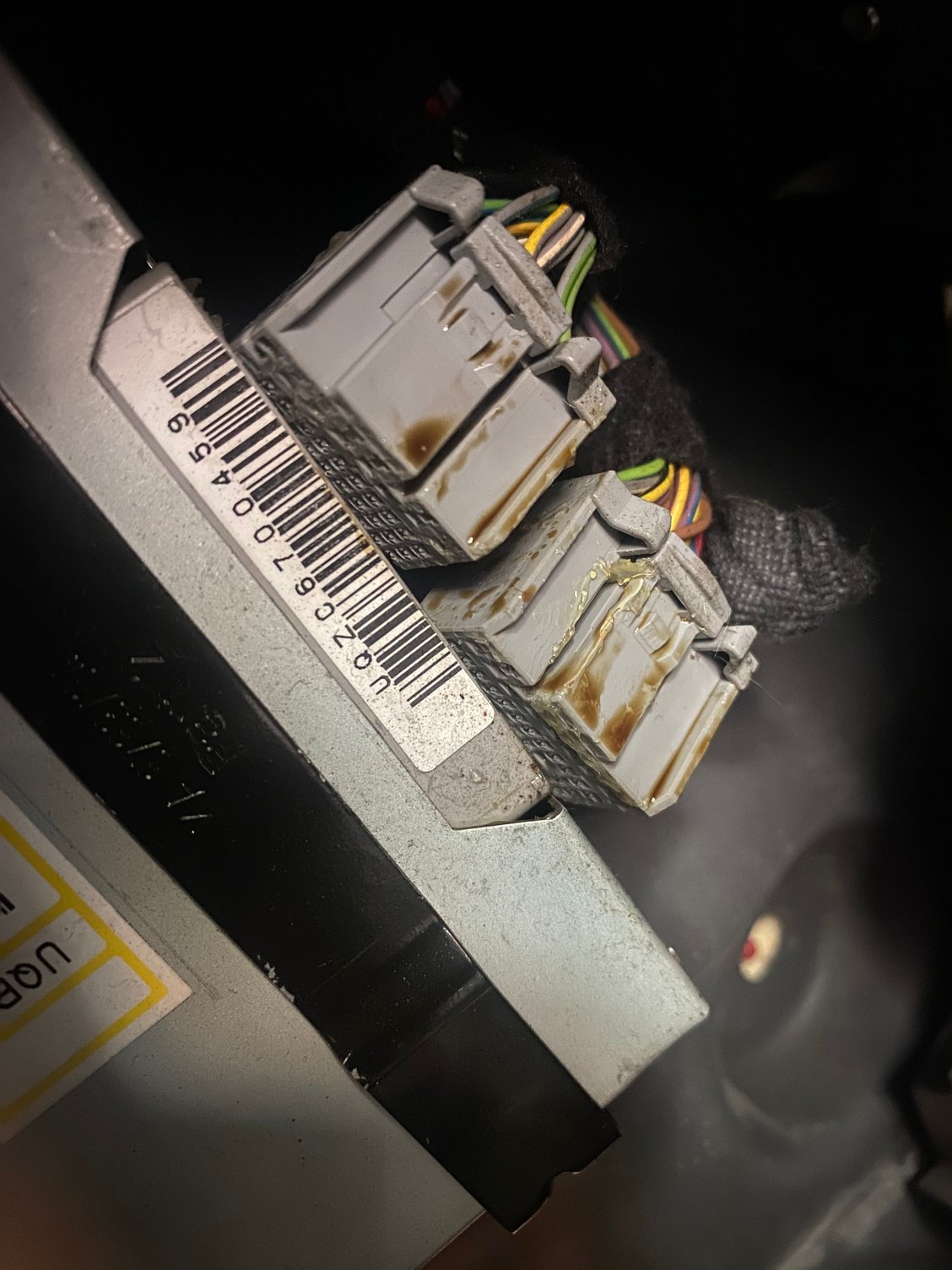

Module plugs!
Found the module over foot pedals and for my surprise the plugs look like that. Is it normal? Wondering where that residue is coming from.

Yes, looks like brake fluid or oil from above dripped on it. Check the lines under the dash and footwell.
clean everything and now the transmission module is connecting to INPA. I guess is working.

Its the fluid coming from somewhere else, did you find out where its coming from? You got a leak somewhere.
Its leaking on the unit near the harness.

Brake fluid
Looks like is brake fluid. Is right above where de reservoir stays

Ok, yep my guess is the cap at the reservoir, connection point #5 or one of the lines? If its the lines it might not be tight on the master cylinder
