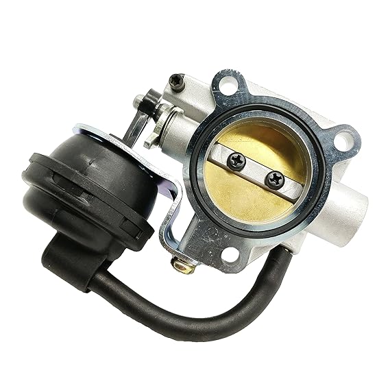

Yes, the bypass valve pops off, but instead of throwing the pressure to the outside, it goes back into the intake system. If it does not seal completely, it will throw more air into the system and cause a lean condition.
Things that can go wrong with this device are:
cracked or off vacuum hose
stuck butterfly shaft
gummed up
broken vacuum pot
broken or weak spring
leaking o-ring
