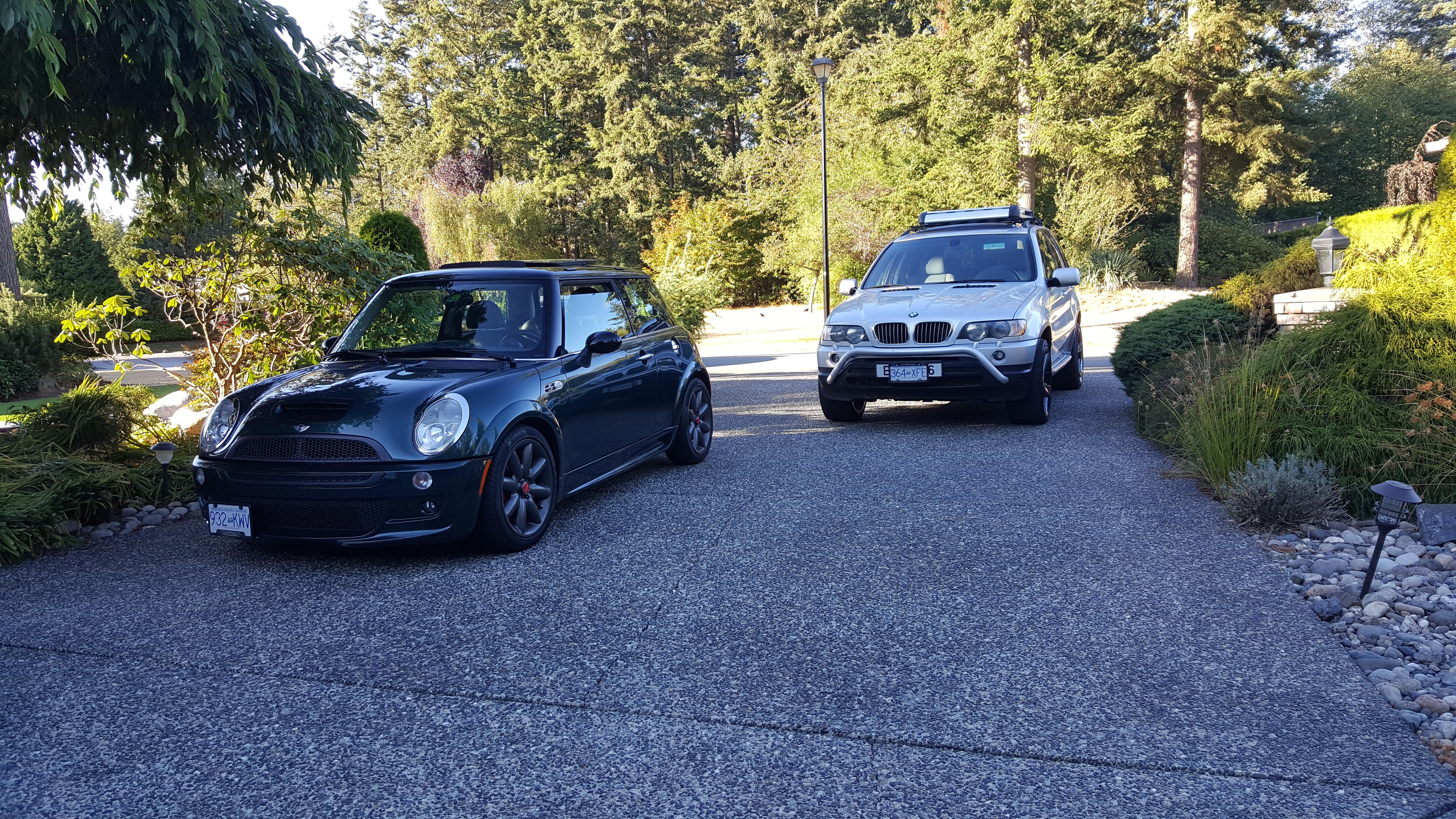

Nice score, and I am on the fence about doing my arches body color everyone here local says don’t do it.... the more I see cars with them painted the more I like them. Good luck on your journey with the rebuild

Just do it. You will like it
