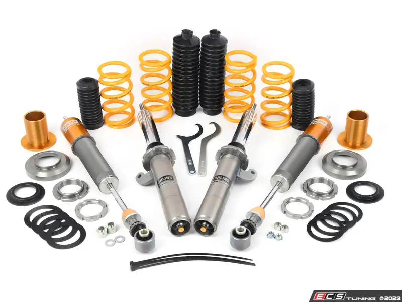

And one more interesting thing: I was recently looking at the Ohlin "Road & Track" coilovers. I don't actually need these, but their ad says it uses a front UPSIDE-DOWN Macpherson strut. Now I'm pretty confused, but it makes me think MacPhersons can't be all that bad. (I still don't understand how they differ from coilovers, FWIW)
SO HERE'S WHAT I'M THINKING:
As per the thread title, Does it make any sense to switch to coilovers in the rear, so I can fine-tune the height, but use lowering springs in front, so I can keep the MacPherson struts and dynamic damping?
This would be expensive, but I'm just looking for the best overall solution.

Dampening is what you need. Kw V1 or V2 or similar. ECS coilovers are great but not as refined as say an Ohlins or KW V2+ on dampening and rebound. They are like an ST+. Its up to you and your price range.
AGT - dont know about them (dont carry them), KW, AST. Moton, Ohlins are the higher end coilovers. I believe AST/Moton are inverted. On coilovers if the body has additional adjustment then that means you can have more adjustment.

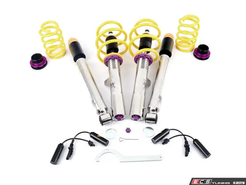

Here's an odd wrinkle:
I queried KW directly about their specific kits, and their tech Ron replied that according to his app guide, KW doesn't make ANY coilover kits for the F57.
This seems strange since the ECS selector says they do fit, as does an actual KW advertisement, (showing the F57) as does an independent review showing an F57 with the V3 Street Performance kit installed.
Ughhh......
Ughhh......

+1 they physically fit. Lots of people whom make coilovers dont test on every platform/chassis, so they just catalog to select models they have tested. People who know the Make will go beyond that.
Yep its heaver in the back and with the top down you get a little more weight in the back.
What people do is set the ride height level with the coilovers to their liking. With coilovers you can dial that in. Thats the beauty of them.

KW eventually got back to me. There's something wrong in their database that keeps showing the F57 JCW as non-compatible, but as you guys say it IS. They have now confirmed their part #180200AU
- Super confusing because they also have a "Street Comfort V2" which is a DIFFERENT part number, and there is no Street Comfort V1 or V3. (And of course there's the Street Performance series, 1-2, which have stiffer springs.) Also, ECS has a different part number showing for a 2024 JCW F57, and I think KW got it wrong. Again.
KW really needs to get their data & their advertising together. It's ridiculous.
Sadly, I still don't know how low the Street Comfort can go in the rear, specifically on a JCW F57. They actually couldn't tell me ! I may have to just take a chance.
One good thing I found out today: The street comfort is said to be a PITA to adjust in the rear, as you have to drop the control arms to do it. However, I was just told that you can drill 2 holes in your trunk, then buy their KW extension kit and adjust from the trunk, I think this is an acceptable solution, as long as it can be made waterproof.

Thanks again, ECS. So to be clear:
The listing ECS shows as correct, for my 2024 JCW F57, is part #180200AH, and this is definitely correct, yes? (KW was wrong in telling me to get the AU ?)
Also a few more questions, if you have the answers:
1 - Has anyone reported how low this kit can go on an F57 JCW? I know there are limitations, yet KW themselves don't have the data. All they can tell me is the recommended safe limits of the coilovers themselves. (not car-specific) - And I can't find any user data online for this.
2: I'll need an extension kit for rear adjustment, but KW makes around 20 different sizes, including two different wrench diameters. Do you know which one I'd need? And do you know how to make the required trunk holes waterproof?
3 - Are there any other components that you recommend changing at the same time, to increase tweakability? I don't do my own work, so it's less expensive to have the shop do everything at once, Plus that might aid in his dialing it in. (Yes, with me doing the driving.) I'll be adding a thick rear sway bar, since many folks say that helps even with street driving. But I'm here wondering about things like adjustable drop links, adjustable rear-bottom control arm, or maybe even camber plates.
- But again, this is only for "spirited" street driving. Note also that I have slightly wider wheels and tires, making my scrub radius about 14mm less negative than stock.
4 - In general, are people happy with the ride, when replacing a modern F56 / 57 that has DDC, with this kit? (I'm mainly concerned with lowering and leveling the car, but I don't want the ride to get significantly more bumpy.) Again, I have yet to find a single user comment on this specific swap, anywhere.
THANKS !
THANKS !
Glad to help.
Ok i see what they did they used the F55 which is heavier in the back as the F57 fitment. Seen this with other brands, not just KW. When we built the catalog they did not have F55 at the time. Only F56 and no other options and we know F56 stuff fits F57. Its just a convertible that is slightly heavier in the back. Coilovers can be ride height adjusted to compensate that.
They also dont even have anything listed for the F57 on the USA site and the last file I have has no F57. Just F56 and F55.
I can update our listings to reflect this change.
https://www.ecstuning.com/b-kw-suspe...rs/180200aukt/ is not EDC/DDC which is correct as EDC and DDC on end year MINIs changed and its not plug wires and its mechanical. Pin size on struts should be NON EDC: https://www.motoringfile.com/2025/04...e-comfortable/
