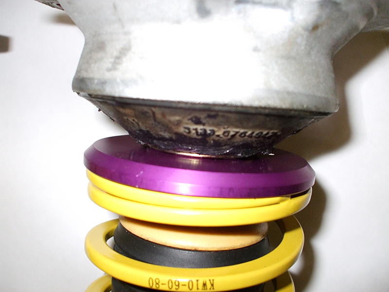

KW Springs
I have just converted my KW version 3 to parallel springs, 61 mm ID.
On the rear Helper spring 20-60-80, main 60nm x 140 mm
On the front Helper spring 10-60-80, main 60nm x 160 mm
You also need the intermediate spring perches to connect main to helper.
And upper spring seats flat design 14 mm bore product no 65030007 to replace the OEM large pressed steel.
These are 50% stronger than the supplied springs.
Hope the information is of some help.

I will try and post some pictures.

KW Springs
Pictures of the KW springs
