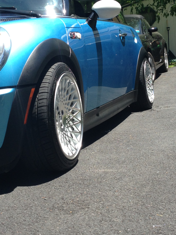

I have h&r coilovers. They are very comfortable. I daily and I have pretty slammed. I haven't had an issue yet and they where about $1000
Attached Thumbnails Ordering coilovers!-image-4042751014.jpg   Ordering coilovers!-image-1043621312.jpg   Ordering coilovers!-image-650739932.jpg   Ordering coilovers!-image-3645401679.jpg
That looks niiiiize
