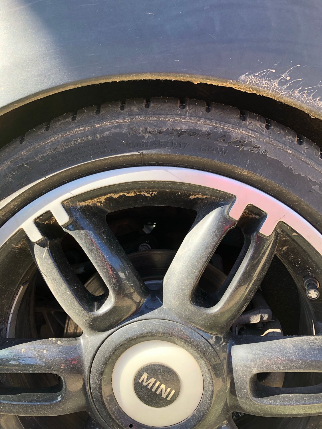

Awesome, thanks for all the feedback. I had been delaying on shocks/struts because I couldn't decide on the direction that I wanted to go. Maybe you can help me with that decision I had 3 options I was considering. The main issue I have that is different than most is I'm a bike racer. I regularly carry 2-3 bikes and gear on a hitch mounted rack, which lowers the rear end about 3/4" inch. My concern with sport springs or coilovers would be bottoming out when I have the car loaded up. I'd love to have the car sit a little lower, but don't want to regret that every weekend we load up for the races and don't want to turn it into a harsh ride for everyday driving.
These were the options I was thinking of, and would love some feedback. I've attached a few photos to show the empty and loaded ride heights in the rear
  1. Koni Special Active/FSDs, keep the stock springs. This was the least expensive and most likely to give a good result.
  2. NM r55 or H&R Sport spring and Koni Yellows. Pricier, might rub
  3. Coilovers. Even more pricey, was looking for something used that might be like the Bilstein GP setup where it would still retain some compliance.
Thanks in advance!
MJ
stock ride height
loaded ride height, but seems to tuck under
rear rack setup

That is a hugely different question than the usual question posted on NAM....
The thing that you are going to run up against is that after market springs are going to lower the car. The least lowering spring is likely to be the TSW that Way motors carries:
https://www.waymotorworks.com/tsw-mi...6-r55-r57.html
Not sure if that will wok on a Clubman, though. Way motors is usually pretty helpful with question so he may chime in with a suggestion or you can contact him.
The MINI Sports Suspension option came with stiffer springs than the base S. You could see if you could find a set of those. The will retain the stock ride height.
For what you are doing I would pair those with Bilstein B6 shocks. I my experience the FSDs are a fit soft, and if you are carrying a load, I would go with a bit more performance. The Bilsteins are also a mono-tube strut, which means the housing to stem is stiffer.
Not sure I would go with coilovers as they tend to lower the car a lot and I would be concerned with wheel travel.
Just some thoughts to consider.
