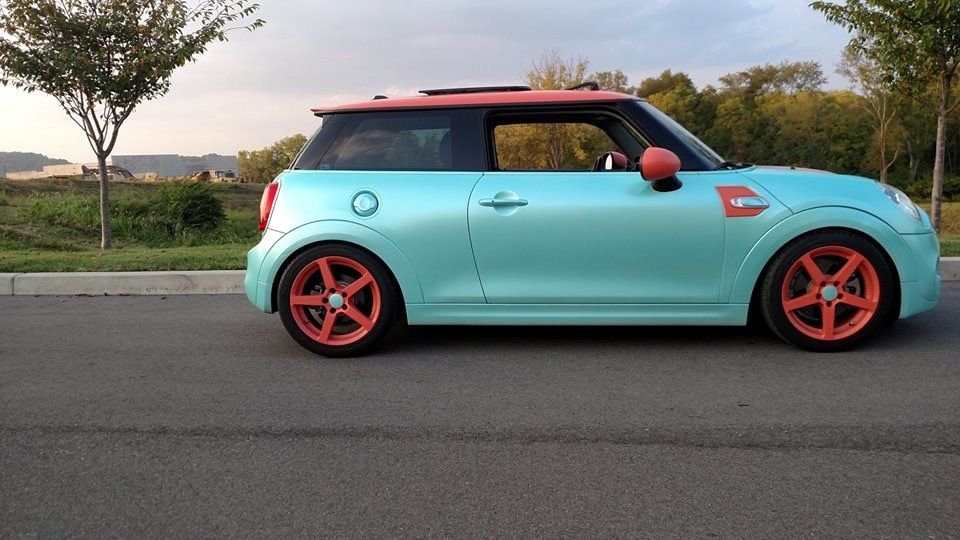

I am on NM springs which sit lower than the JCW Coils. 17x7.5 et45 rims with 225/45/17 tires
Lower? Not sure I see that. Your ground clearance looks to be the same. Sure, your wheel well gap looks to be a lot less, but your tire and wheel package is also 2% greater in circumference than the stock 18's. Merely an illusion. I'm not interested in springs, I'm interested in coilovers.
I was merely showing the drop which is 34mm which is lower, I also realize there is less gap with the slightly larger tire which is one of the reasons I went with the size. Not trying to talk you into springs lol, I would have done coils to if they had been in the budget
