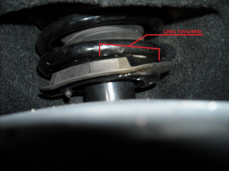

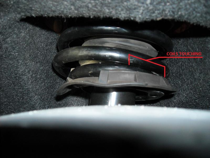

Just installed TSW springs on my 2010 R56 yesterday. And while I haven't got the advertised 3/4" drop in the rear and 1" in the front, I'm still pretty pleased with how it looks and rides. Initial installation netted me about 1/2" drop in the rear and about 3/4" in the front, so far.
Here's my question for those of you out there with TSWs on OEM struts...when sitting static with all the car weight on the ground, do any of you have some touching of the bottom most coil wind to the second wind from the bottom on the front springs? Not talking about having it lifted on a jack where you can see the whole coil spring, I'm talking about looking at the spring through the wheel gap while the car is on the ground. I've attached a couple of pics at the bottom to show you what I mean.
If one or two of you out there can tell me yours is the same way, then I'm fine with it and won't worry about it. But I find the resting point of the bottom of the spring kinda strange.
The car and suspension itself seems to be just fine. I have no squeaking or rubbing noises, seems to handle just fine, and the ride is great. But I want to know if this coil wind situation is the same with some of you, or do I have a problem that needs to be addressed. Rears seem just fine, it's the fronts that do this, and it's the same both left and right side, same spot on both.
So...would someone out there with this setup do me a favor and look inside your wheel gaps, and tell me if your springs are sitting pretty much the same as mine. I know I got them installed exactly how they should be, that was something I double and triple checked in great detail before putting them back on. They are seated on the perch and hat just like they should be (just eliminating that suggestion).

turtle, I'll get a good comparison pic taken tomorrow and post it up. I'm really impressed with the ride and stance, just hope the fact these coilsd touching is not an issue and acceptable for these springs. It doesn't seem to be causing any issues at all, no noises...squeaks...anything. So I do hope it's not an issue to be concerned about. And I'm hoping someone out here tells me there's are similar and ease my mind. And FWIW, I took a look at the coils of the struts on my 99 4Runner, and I find the bottom coil touching the second coil too, though in a bit different way. My current 4Runner struts are now over 5 years old and about 70,000 miles...and never suspected they were ever touching. I wrote to Way at WMW about it too, yet to hear back though.

YES! My JCW looks the same... didn't realize it til you made me look. But as you stated I have no issues.
But again to confirm... my springs have the same issue/look.

Thanks buddy! Just wanted to hear I wasn't alone. I've got a couple hundred miles on them now, and seem to be perfectly fine. I did get a reply from Way too on this, and he even told me it was ok. So I'm not gonna worry, I haven't heard a single pop or chatter since I put them on, except for a couple little tiny ones the first mile or two I drove it.

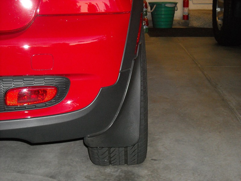

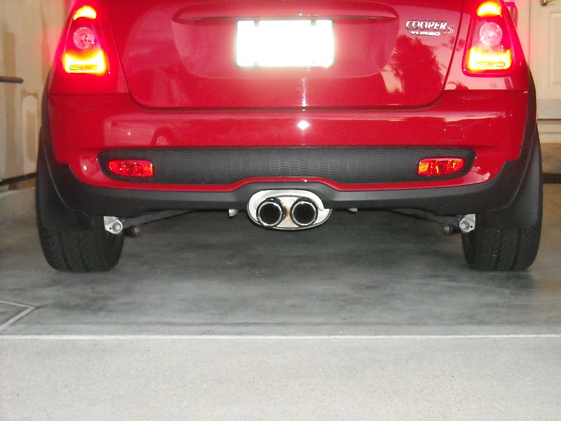

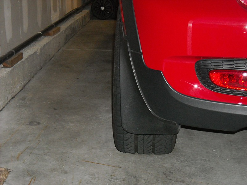

She'll still continue to settle a bit I'm sure...which is fine. Hopefully the front will get to the 1 inch mark, but I have my doubts. Last measurement check was 3/4" rear, and 13/16" front.
Alignment done, that's what I've been talking about over in this thread: https://www.northamericanmotoring.co...-question.html. I'm happy now, they got the alignment where I wanted it, after some bad initial readings (I believe). As for control arms, don't think I need them at this point. There's a little wiggle room in the stock adjusters, and I had just enough to get them where I wanted them. But I'm fresh out of any more adjustment. If I want to take out any more camber (to the positive), then I'll need some arms.
Pictures below are my rear camber at -1.4.
