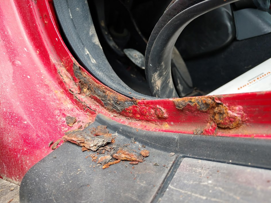

Originally Posted by Blue R50
My R50 is a Southern car that has lived it's entire life in the Tampa Bay area and yes, it has some rust on the pinch weld under the door seal. It's the only rust the car has though, so I count myself lucky.
It is great being Down South, but I too have some sill rust which bums me out, however, I too count myself lucky as our Northern friends have a rough go of the never-sleeping rust-monster...
...recently saw this rustbucket at a wrecking yard in North Carolina,
Classy Chassy indeed!
Rust :: door sill area of '02-'05 MINIs-yanpzlt.jpg
Michigan ain't no joke, it will eat up the car.

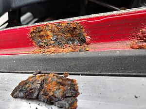

Sill rust of course:
Rust :: door sill area of '02-'05 MINIs-t6wt2qi.jpg
Rust :: door sill area of '02-'05 MINIs-jfp5u06.jpg
Another well known hot spot:

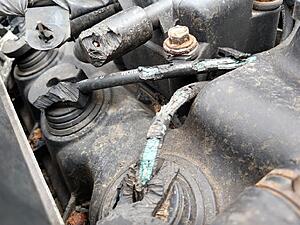

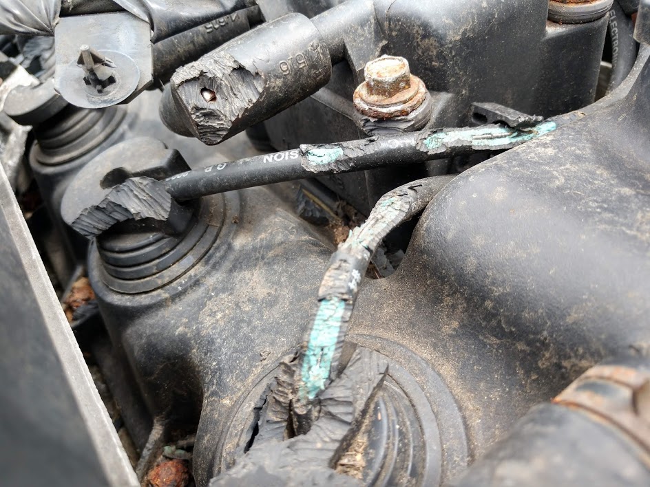

Adding insult to injury,
rodent damage!
Rust :: door sill area of '02-'05 MINIs-6byvrc5.jpg
Also note how stupid rusty those expensive valve cover bolts are!

MINI spark plug boots are a tasty treat for rodents. I think there are soy products in them.
