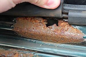

Originally Posted by veggivet
Just look at the pictures, which are of the sill of the hatch...
My pictures are of the door sills.
Both sides rusted equally bad.
Dean.

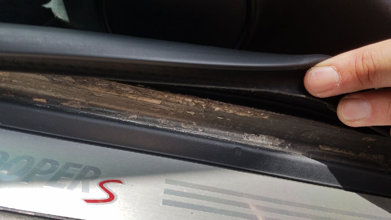

I've found a few R53's for sale that meet my requirements, but nearly all have had door sill rust, some worse than others. I'm willing to fix minor spots, but generally won't even consider a car with any rust on it.
Having said that, I found a nice R53 that I'm interested in, but upon asking the owner to pull the sill seals, we found this (attached). The car has been a Southern car it's entire life, and dealer maintained the entire way; outstanding records.
What do you guys make of this? Bit of a silly question, as we're all just guessing, but it looks like someone tried to glue the sill seal onto the car. Pretty difficult to tell what's under there if anything.
It looks to me like soap from the car wash! Maybe some sort of calcification?

He said it felt like old rubber adhesive. Like I said, bit of a loaded question on my part. It looks as if the weather stripping was glued on at some point. Hard to tell if there's anything under there.

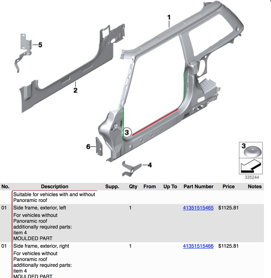

I echo BigChill's words of caution. In addition to the scenario that I wrote about, there is one that I didn't think of, but my tongue and cheek remark of water's 3 states spawned the idea. It may just be from evaporation of water in the sill box section.
In just about all unibody cars the sill beam is a part of the drainage system. After rain and wash most water drips out from the drain holes on the underbody pinched and welded seam. Some that remain will sit inside the sill until evaporates from wind or just still air and some literally never. This water vapour will distribute everywhere there is air space, including right under the rubber door seal. The problem is the inverted V-pinch of the rubber seal do not allow this water vapour to escape. Eventually the paint protection is breached and rust forms.
I post a screen shot of the sill panels but it may take some time for NAM to digest as it hasn't show up yet.

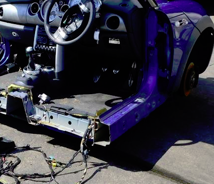

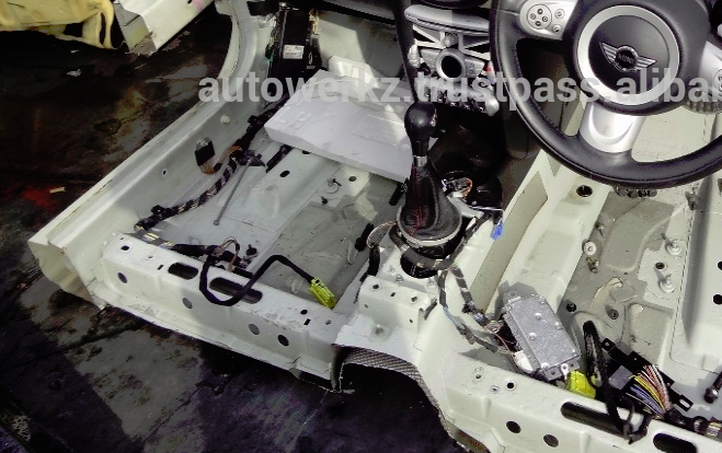

Just came across a rather odd Craigslist ad which features a Japanese R53 cut in half --- it offers a cutaway view of the sill:
Rust :: door sill area of '02-'05 MINIs-rd0hwdc.png
Rust :: door sill area of '02-'05 MINIs-gb9icx4.png
Rust :: door sill area of '02-'05 MINIs-yf7rlik.png
Don't know if it's any real help though as I can't see anything obvious as to where moisture would be entering?

There is nothing unusual about the Mini's. Virtually all your consumer product automobiles with unibody construction share this commonality. Low cost box beams at the sill formed by the same sheet metal with robotic spot welds. They are then zinc dipped and modern sealant applied for reasonable rust protection for the duration of the planned longevity of the car in the worst geographies. What you don't see is how the rain water funneled into the box beam which is a part of the drainage system that they act like sewage channels .
Sometimes the drain hole formed by the bottom sheet metal can be clogged by organic matter like leaves, and that causes accelerated rust, especially in hot summer with winter snow.
