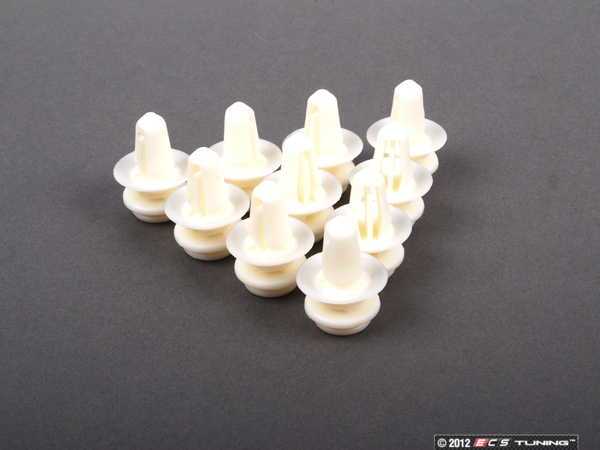

The kick panel is held in with clips, You can pull on the panel near the font to pop it out.
Watch those little clips as they like to snap off. There are a bunch of them on that main panel.

If you have one of those trim removal tools that will make your life a little easier. The little clips are a pain but what is more of a pain is when the panel itself tears out instead of the clip pulling out. Other than that it's not a particularly difficult operation. Just a little awkward because seat/steering wheel/pedals/etc. in the way.
