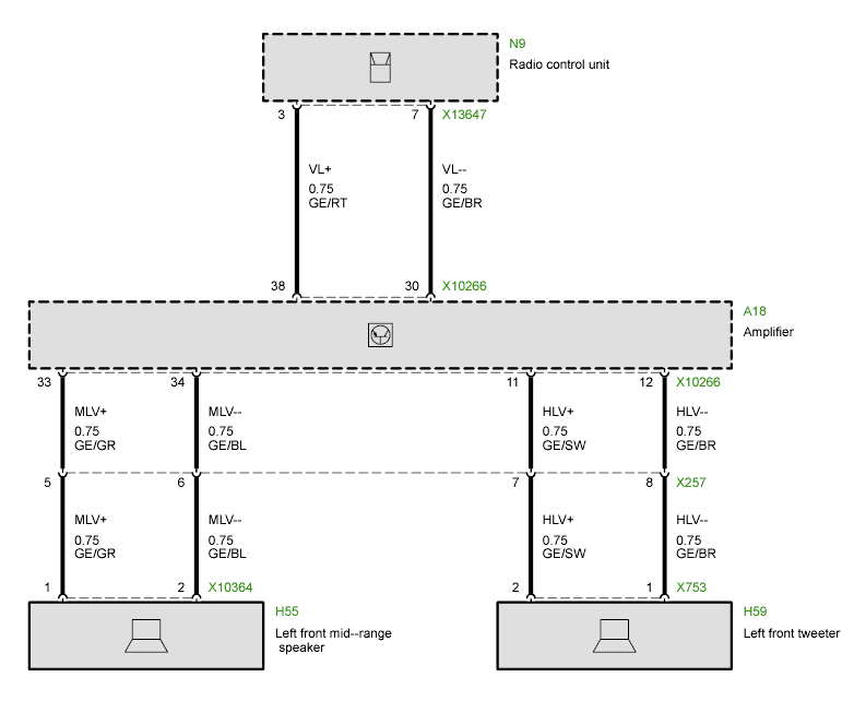

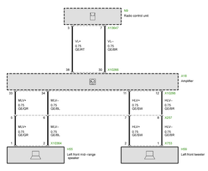

This is the HK wiring:

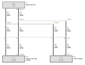

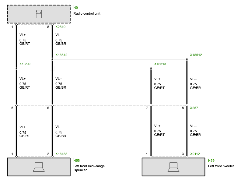

This is the standard stereo system:
The X18512/X18513 connector that splits the signal is in the dash near the steering wheel.
My wiring diagrams are from the BMW WDS (Wiring Diagram System) software. Search eBay for "BMW WDS".

Thanks for all of this, rkw. I used a .pdf of the amp output speaker colors, which lead all the way up to the door plugs - where they completely change colors. I used and tapped into the tweeter wiring just inside the car's door plugs (from my amp) and those wires went directly to my individual door crossovers > split into tweets and mids.
Fired it all up today and it sounds excellent! Haven't done any balancing or filtering yet, just wanted to make sure it all works before putting the panels back on. Still have to hook up the PAC-SWI, tuck everything away and re-assemble the interior.
