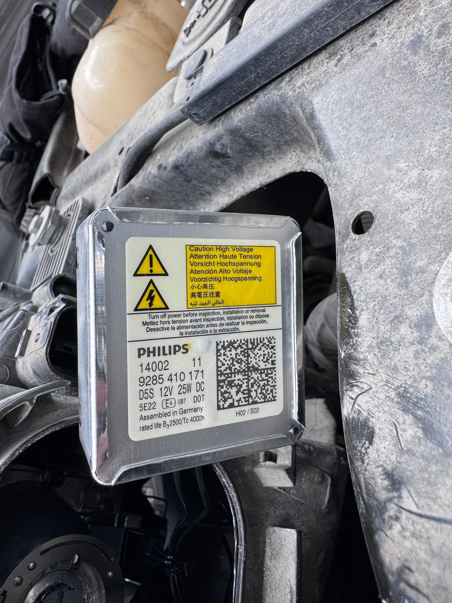

Wondering if anyone has seen this discrepancy. I went to change my Xenon bulbs and while the Philips site says D1S C1 35w is the correct bulb for the 2014 Countryman, when I went to remove my bulbs, it shows D5S 25w.
Has anyone run into this? Which bulb did you end up installing?

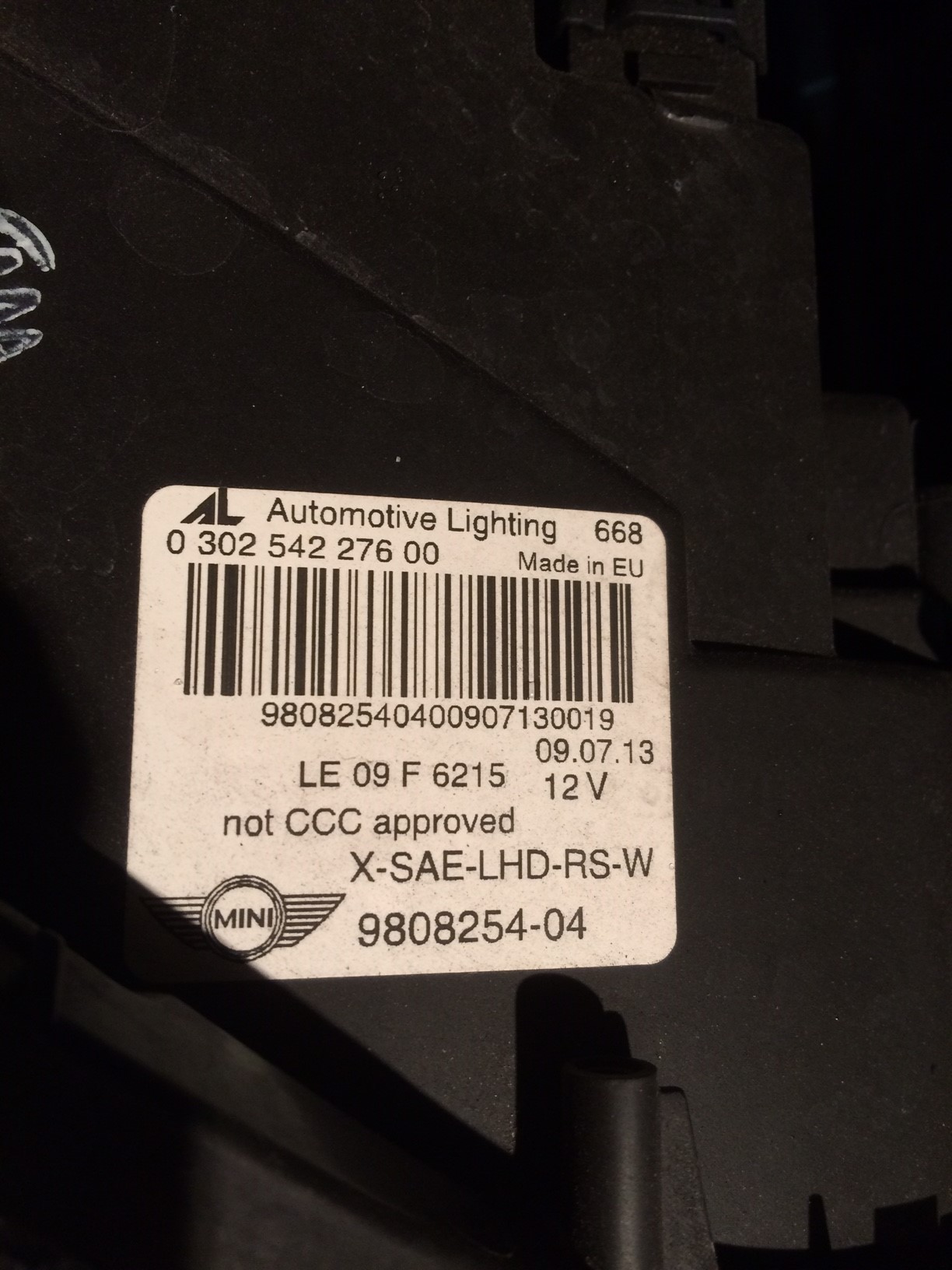

The factory supplied xenon headlights used the D1S bulbs, the dealer installed accessory xenon headlights utilized the D5S bulbs. Looks like your car has the dealer accessory headlights.

Yep its the old kit thats NLA its 25W VS 35W
https://www.northamericanmotoring.co...r-r60-r62.html
https://www.ecstuning.com/News/MINI_...012_2013_2014/
ECS News - MINI R60/R61 Genuine Xenon Headlight Kit
Options for bulbs/ignitor.

ECS wasn't able to get stock of the OEM bulb. Morimoto said their bulbs 'may not work in automatic mode because there is a difference in amps. The ballast and igniter are integrated into one unit which requires a stable and consistent power source.' So, decided not to try theirs.
No luck ordering Philips D5S bulbs from Amazon.
So I've got an Osram bulb on order from LEDPerf. I'll post an update once received on how they work out.
