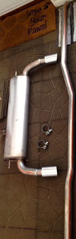

Originally Posted by Dozuki01
Great job on the video and thank you for sharing. How did you re-install the new pipe and did the JCW exhaust kit come with the clamp.
Thanks.
Thanks. The new pipe simply slides over the OEM pipe that you have to cut, then secure with a clamp. The muffler then slides over the other end of the pipe and you clamp that as well. The JCW kit does come with 2 clamps. I have attached a pic of what you get in the boxes. The tips are not on all the way in the picture. The other is showing that the actual muffler says JCW on it, whereas, the OEM muffler does not.
Attached Thumbnails JCW Exhaust Install Video-jcw-1.jpg   JCW Exhaust Install Video-jcw-3.jpg

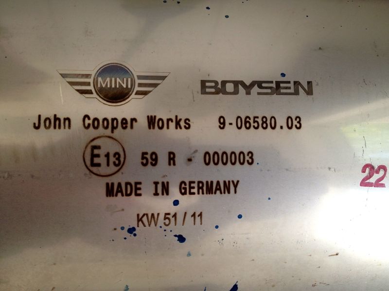

Originally Posted by broussardc
Amy, Could you tell if there is any difference between the stock and jcw muffler? Or is the jcw kit really just a resonator delete kit?
I can't say anything about the internals of the muffler itself. They do look almost the same, but the new muffler does have a JCW stamped on it though.
I know the tips are actually R56 tips, as the JCW has the tips attached to the body kit so the muffler itself doesn't have any tips welded on it like the factory S muffler does. That being said, I am sure most of the sound is from the resonator delete pipe, but supposedly the internals of the JCW muffler are less restrictive as well.
