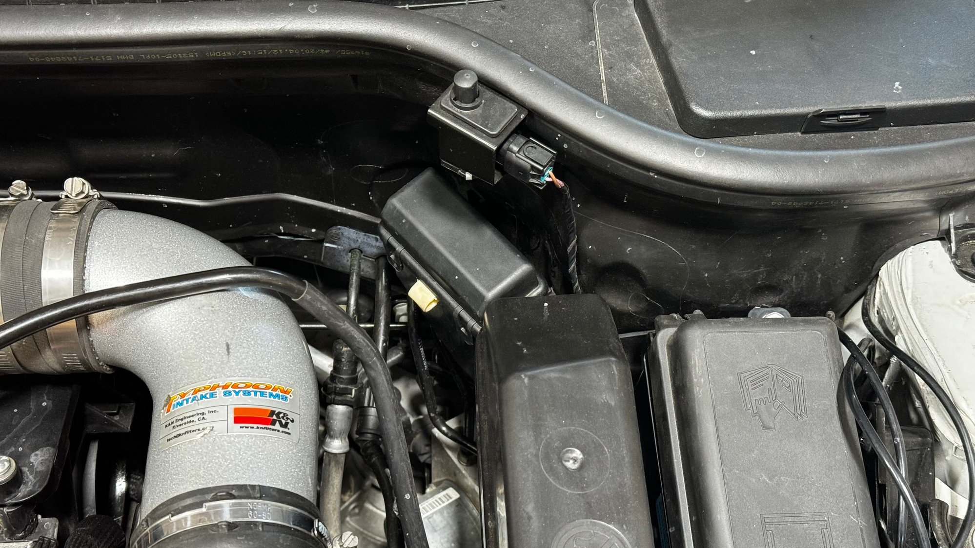

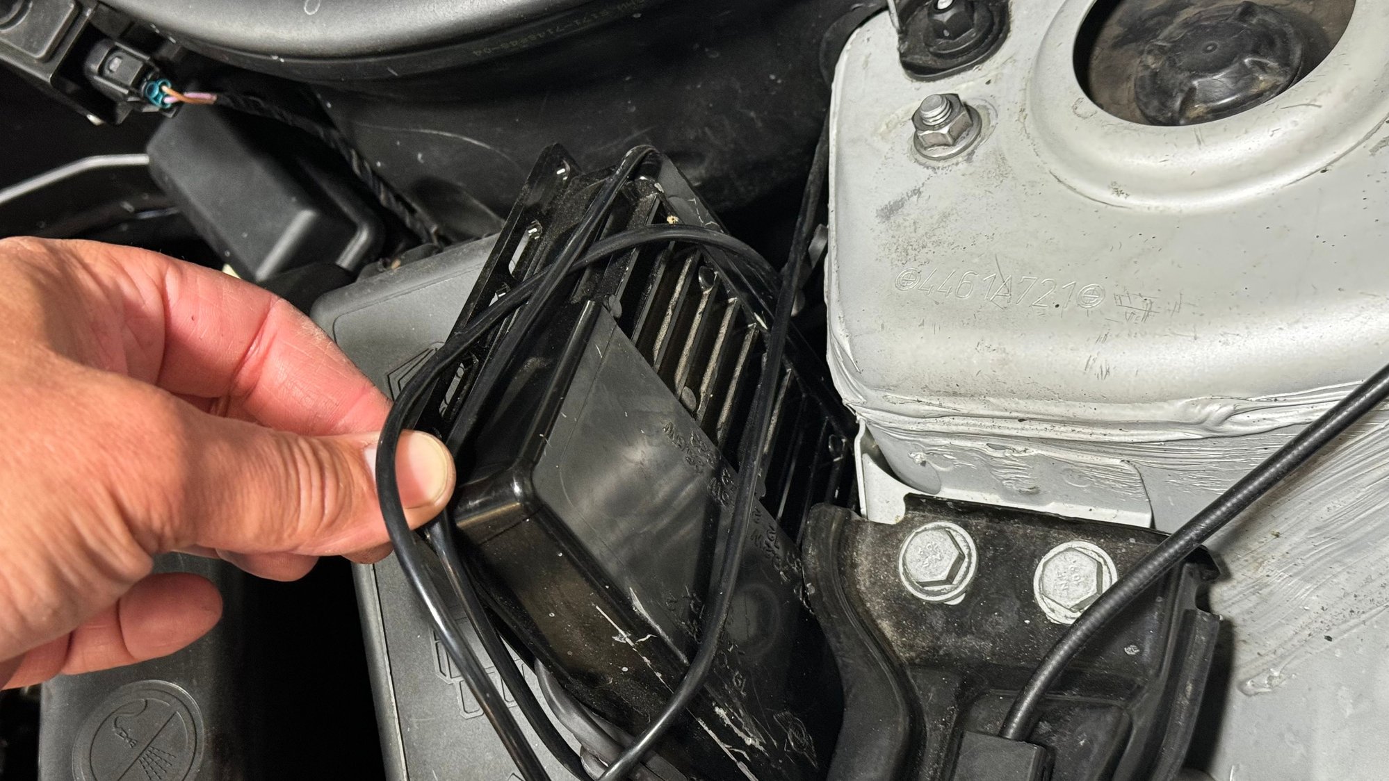

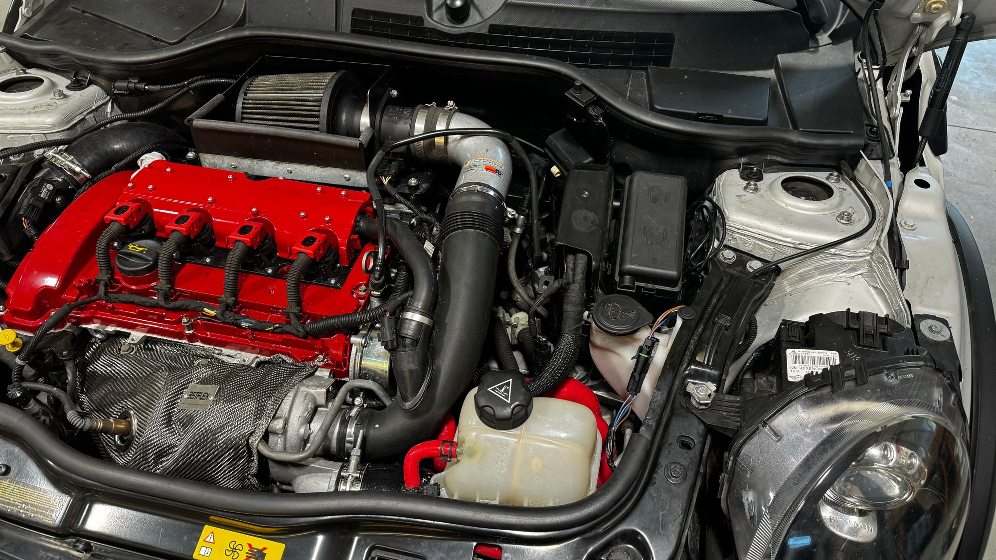

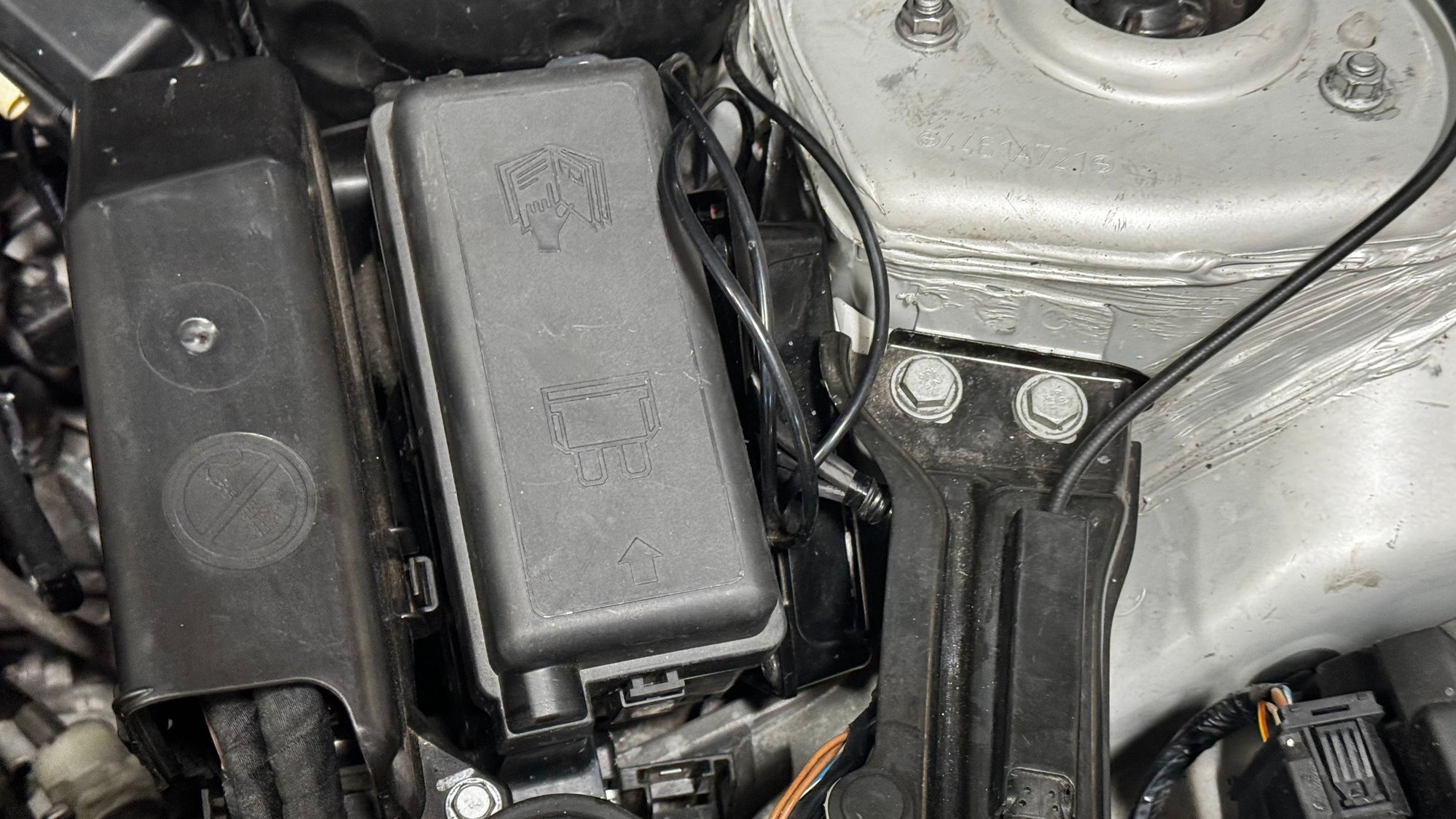

After a 2 month rebuild, got car back together and figure lights aren't working. Toggle shows lights on dash, went to check bulb land I don't see a bulb. It's a 6 wire plug that connects each fog. There appears to be a halo DRL on them too that doesn't work, bit oddly did with blinker (figure that one out). I've checked power wire to the black box under hood that looks like a ballast and has mini logo on it. Box is grounded as well, someone it has + & - to it.
Do you think previous owner swapped fog lights from a different MC?
What is box on fire wall under hood switch?
Ballast wedged next to strut tower and fuse box.
Is this a R58 factory fog controller?

I think someone swapped LED fogs into it over its life.
Old Jun 5, 2024 | 06:56 AM
Posts: 36,760
Likes: 2,549
Yep they got the old and nla fog led kit from MINI

@ECS Tuning You are spot on. I have this retrofit kit installed on my 2012 R56 MCS and module box looks exactly the same.@MiniConn I would check wiring. There is one wire that should go through firewall into cabin and connect to FRM. Also, if IIRC I had to do some programming to get rid of strobing on start. Search for "MINI LED DRL retrofit kit" (or something like this) and you should find a few threads discussing installation details here.

Just in case though - check that inline fuse for DRLs is good. I had that fuse blown in the past. Literally blown. Even the holder was damaged and I had to install completely new inline fuse with holder. This thread has some pictures: https://www.northamericanmotoring.co...d-drl-kit.html
