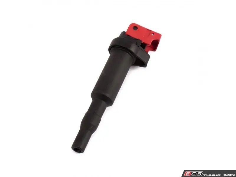

I know coils can be an issue so I purchased new coils from ECS https://www.ecstuning.com/b-bavarian...t-of-4/5005kt/
and new NGK plugs. I have always been a big fan of NGK since my dirt bike days back in the 80's. I figure if this isn't the issue, I have them for when it is.

Swapped coils from 2 to 1 and error code chased the coil to cylinder #1.
Coils are here, plugs get here tomorrow. Will not have the chance to change them till next weekend. Just going to have to baby it for the week. It only does it under heavy acceleration.
BTW, I do think they are original coils. Bosch brand.

I do have a question about the coils
Some appear to have a metal sleeve around them, some do not. When I switched 1 & 2 they didn't have this. Could they have remained in the spark plug hole?

Just different designs. I don't believe one is better than the other, just different.
I am currently running the Bavarian Autosport coils. I wouldn't have any reservation running the Dinan coils as an alternate..

Actually, I got the Bavarian as well from ECS.
My originals were Bosch, and I think they had the shell on them. I need to take a good look when I replace them this weekend.
