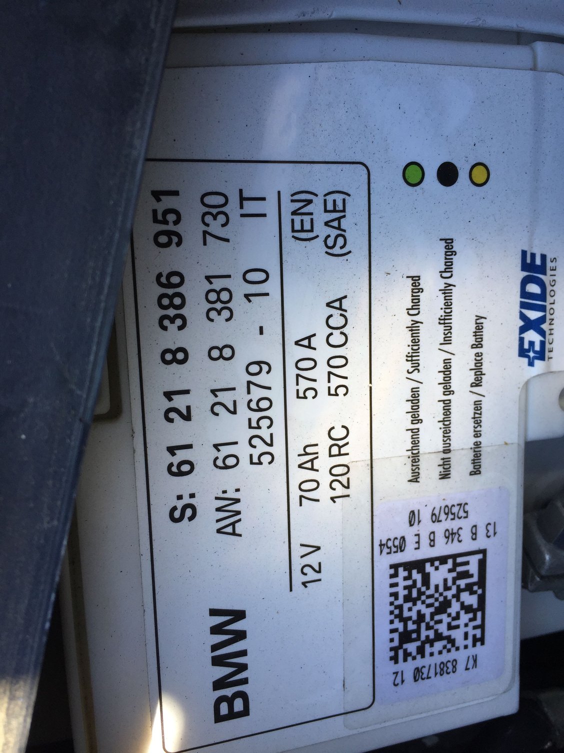

here is the photo of my battery

Yep thats an IBS connector on the negative terminal. I'd recommend registering a new battery.

below is the spec of my current battery.. size is the same... the bosch tech only check the size of my battery they don’t have book for reference.

That battery should be fine. My wife’s 2014 R57 and my 2013 R58 JCW battery’s went bad with in a week of each other. I just went the local parts store and grabbed a new battery. I used my Foxwell to register them. All is good with both cars
