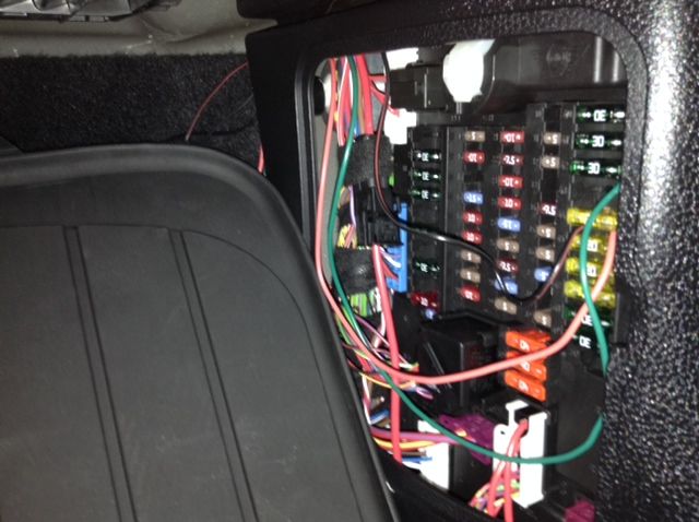

Got the power magic pro wired into the fuse box on the passenger side. Found always on fuse and one that cuts off say after 30 minutes. Ground you see if you drop the glove box on the right - there is a screw.

Fuses
Well, I used several. Blackvue and MagicPro uses one, Passport Radar uses one and I think one other device.

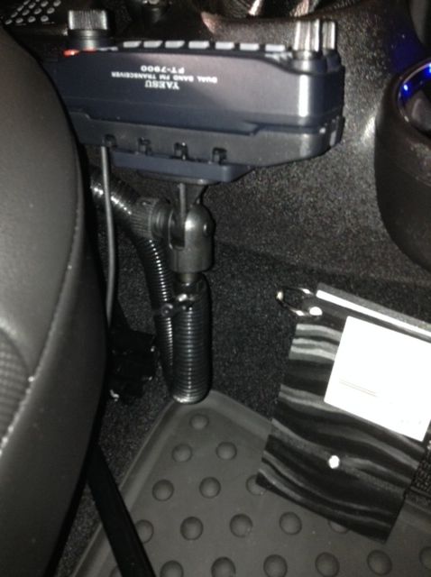

Here is how I mounted the remote head for the Amateur Radio. It connects under the seat rail. Like two fingers. No holes drilled, I could pull everything out of the car and you would not know it had been there!
Just rear of car with antenna on trunk lid - low profile and black.

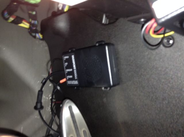

Here is the hidden radar box above the gas peddle.

Best of luck with the wiring, not hard, trial and error until you get one that either stays on all the time or cuts off. I just wrapped the wire around one of the fuse ends. With cover on you can't tell I was in there.
