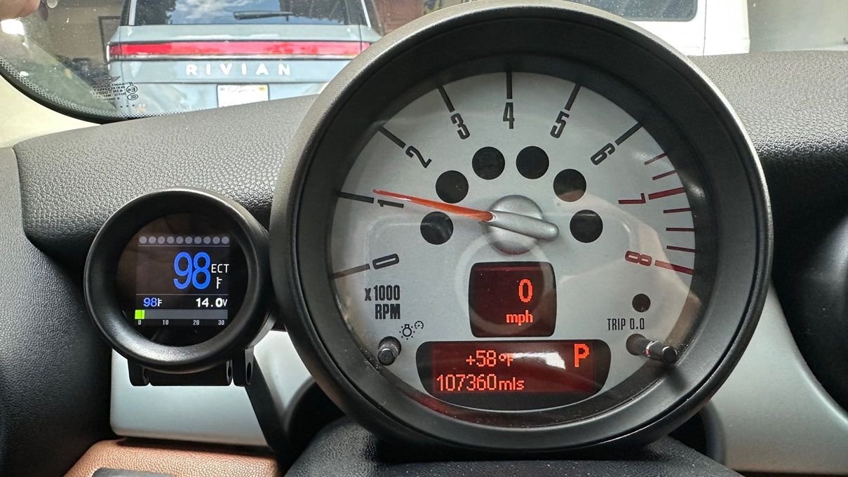

So after looking at whats available, I didnt want to spend $600 on a temp gauge. Additionally, I didnt want to hack into my coolant hose knowing there is a signal from the OBD. So I opted for an OBD connected gauge.
It has other stuff like a tach, volt meter, oil pressure and air/fuel ratio. But I just want the coolant temperature. One neat feature it alerts you on your engine revs when its not at operating temp. Wish it has color illumination options.

Straight from OBD socket. Comes with a long enough harness to get creative with placement.

I meant where did you buy the gauge, who's the manufacturer etc.
Sorry I wasn't clear!
Old Feb 10, 2025 | 06:03 PM
z168's Avatar
z168
Joined: Jul 2015
Posts: 93
Likes: 14
From: SoCal
Woops, misunderstood. Here you go →
