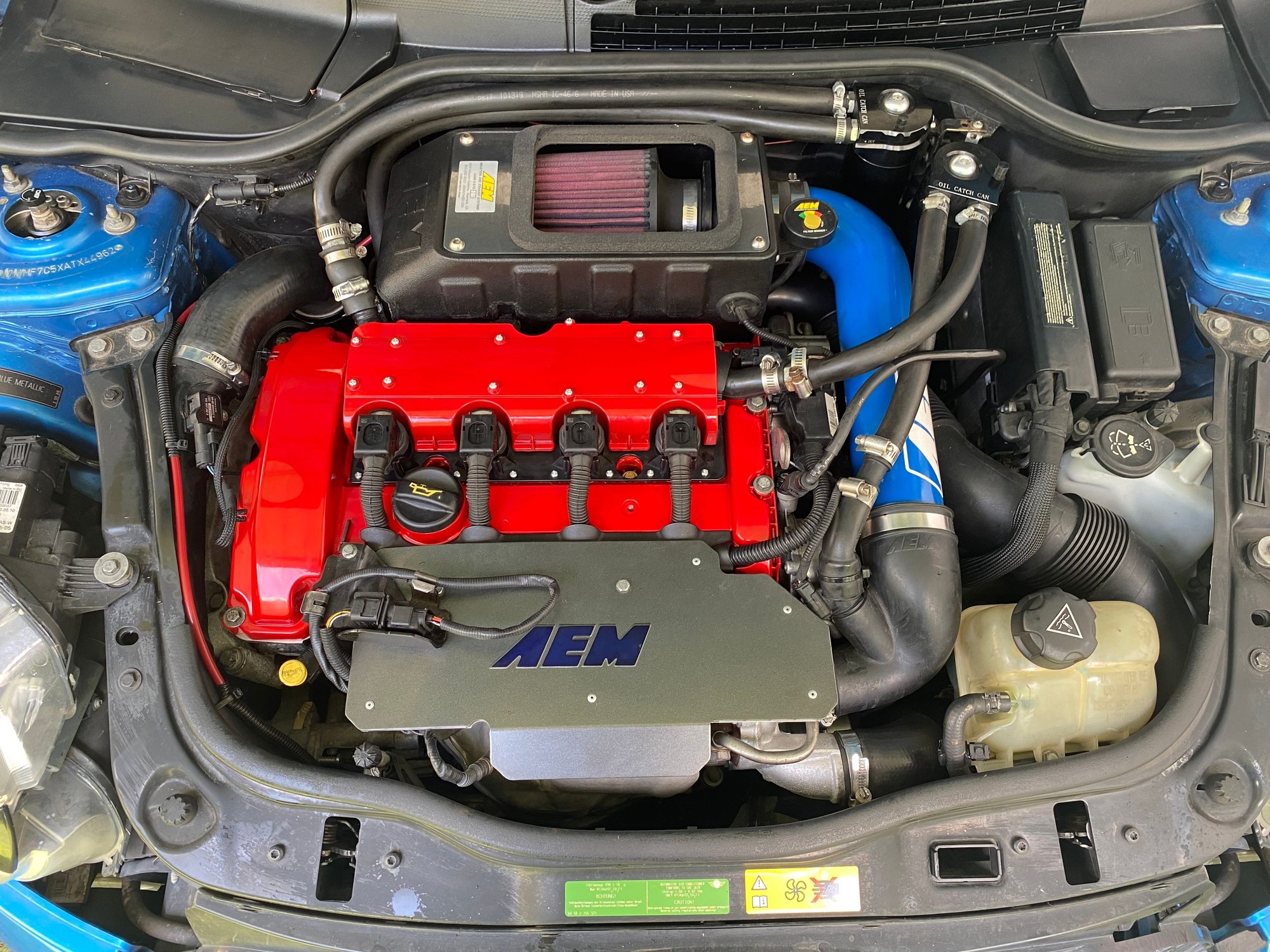

Time for a new valve cover! Should I go with an aluminum valve cover (ECS tuning or eBay) or oem plastic? What are your guys thoughts? 2013 S N18 engine. Thanks!

Installed the aluminum one from ECS 2 weeks ago. Had to loosen the metal fuel hose in the top right corner to get enough play to install it, but once I figured that out, was easy enough. Less PCV vibration/humming at 2k RPM - time will tell if it helps with oil consumption but I'm optimistic.

Wait... no pictures?!?

I'll link in my reddit post, I got the silver one because I thought the red one might look funny.

Thanks. Looks nice! Is it actually painted silver, or is it bare aluminum?

Does the plastic cover on the front still attach?

Yes it did! I just left it off for the picture.

Just installed aluminum valve cover sourced from ebay yesterday!
My previous ebay cheap (~$40) plastic valve-cover failed at 20Kmiles (developed leak on top, oil pooled in recess for top-right center bolt securing valve-cover.
Hopefully, I'll get more than 20K miles on this pretty red aluminum one
