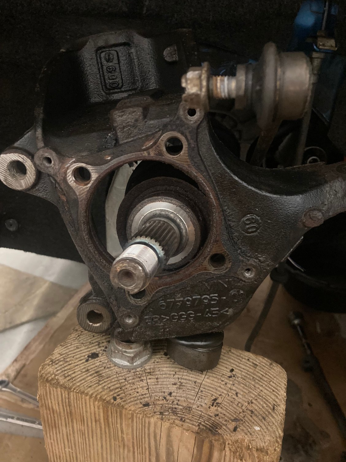

Ball joints removed, fwd strut removed, wheel bearing bottom bolts removed, top bolts are blocked by CV joint.
bentley says to hit end of prop with rubber hammer to remove prop shaft.
is end of prop bolt that holds brake disc?
have not had wheel bearing off before?

Looks like the drive cap & wheel bearing were combined maybe a wheel puller is required.

You'll need to remove that big nut on the end there. That nut holds the drive shaft into the bearing.

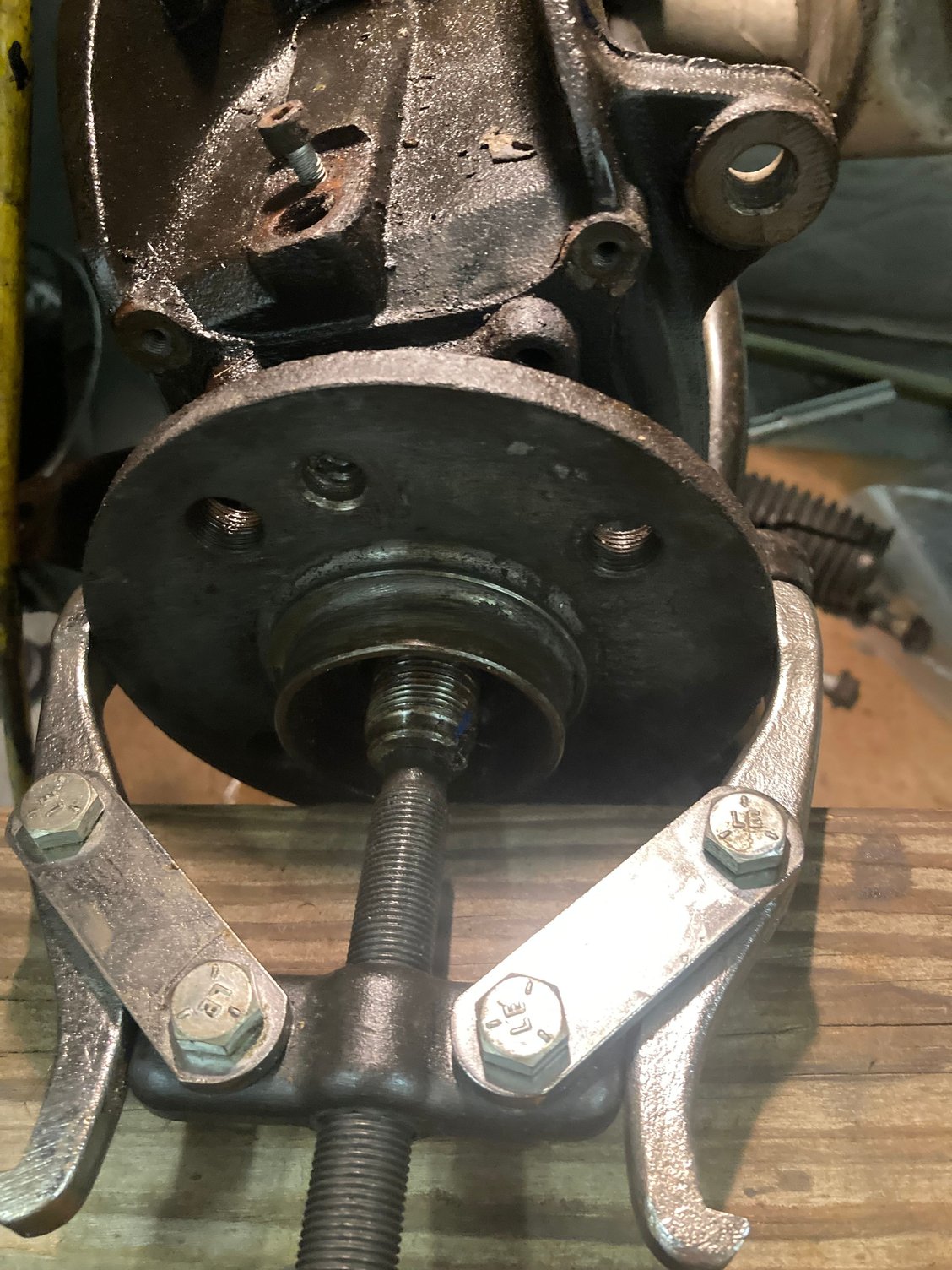

The prop moved with a two point puller but the bolts not so lucky they will move if heated if allowed to cool even a little nada.

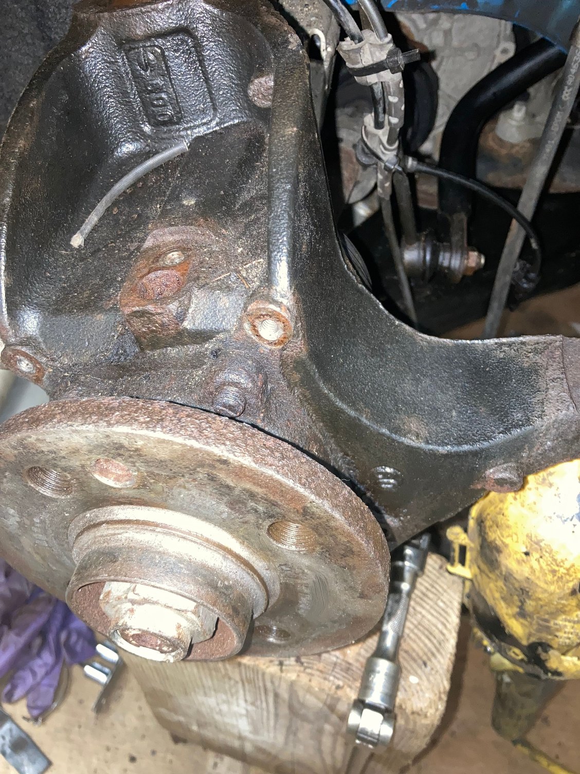

Wheel bearing
If I could get that tool in the very small opening in the undercarriage to the prop shaft it would work.
the bolts to passenger side center mount do turn tho the bottom bolt to get that out there is little room.
drivers side prop shaft came out with a two paw puller not so with the passenger side, stuck.
i will let it sit for a day then try some heat?
one bolt left holding passenger bearing to knuckle.

For what ever reason the L drivers prop came out of the bearing quite easily.
the R passenger side with quite a bit of tension on a puller added heat added extension to lever more & the prop has not budged stuck in wheel bearing? As above I will continue until something gives.

thread the nut back on, and give it a few good whacks with a BFH. Just need to knock it loose.

No amount of wacking seemed to move the bearing prop shaft out.
so next a hydraulic ram, question is I can only acess two of the four bearing threads.
is this enough for this tool or I could get the other two reamed out?
until I get this out this can not go back together!
