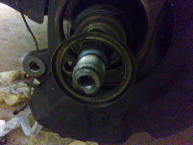

somewhere along the way tis ring came loose and as you can see it got bent
how important is this?
can i just straighten it out the best i can and put it back or do i need a new one?
