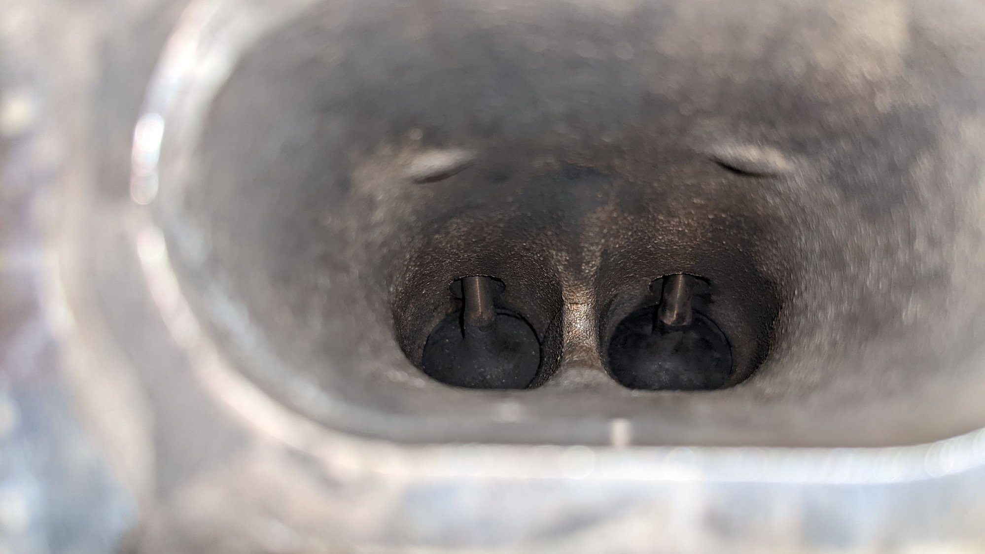

How dirty are my intake valves at 23k miles?
I put a new motor in approx. 23k miles ago, No catch cans (until last few hundred miles). I was changing throttle body, vacuum solenoid (making crazy kazoo noise) and vacuum canister and hoses and was a little shocked at the state of the intake valves after only 23k miles.

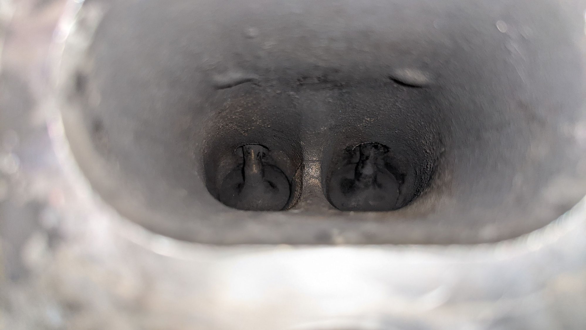

I cleaned them without walnut blasting because I don't have the adaptor that faces backwards...I used Berryman's and some brushes.

N14? Based on what I’ve read, looks normal to me. What are your driving habits? I understand that short trips around town will cause the build up to come quicker. Longer highway trips tend to extend accumulation a little better.

N14 turbo yup. Yes indeed this car sees mostly city use. Looking at other pics of n14 valves this looks pretty standard.

I have a walnut blaster and 80-gallon compressor but I didn't have enough walnut or the vacuum cleaner attachment I didn't feel like making a huge mess doing this.
Is the only good option the metal BMW made vacuum hose adaptor?

There is a 3D printed version available from ECS, but the metal adapter will last for multiple blastings.

Does not look that bad, mine was really greasy and took a couple brushed as they got covered in gunk. The pick i used really helped, then the blaster did the rest. Pick=>Brush=>blaster thats how i did it.
